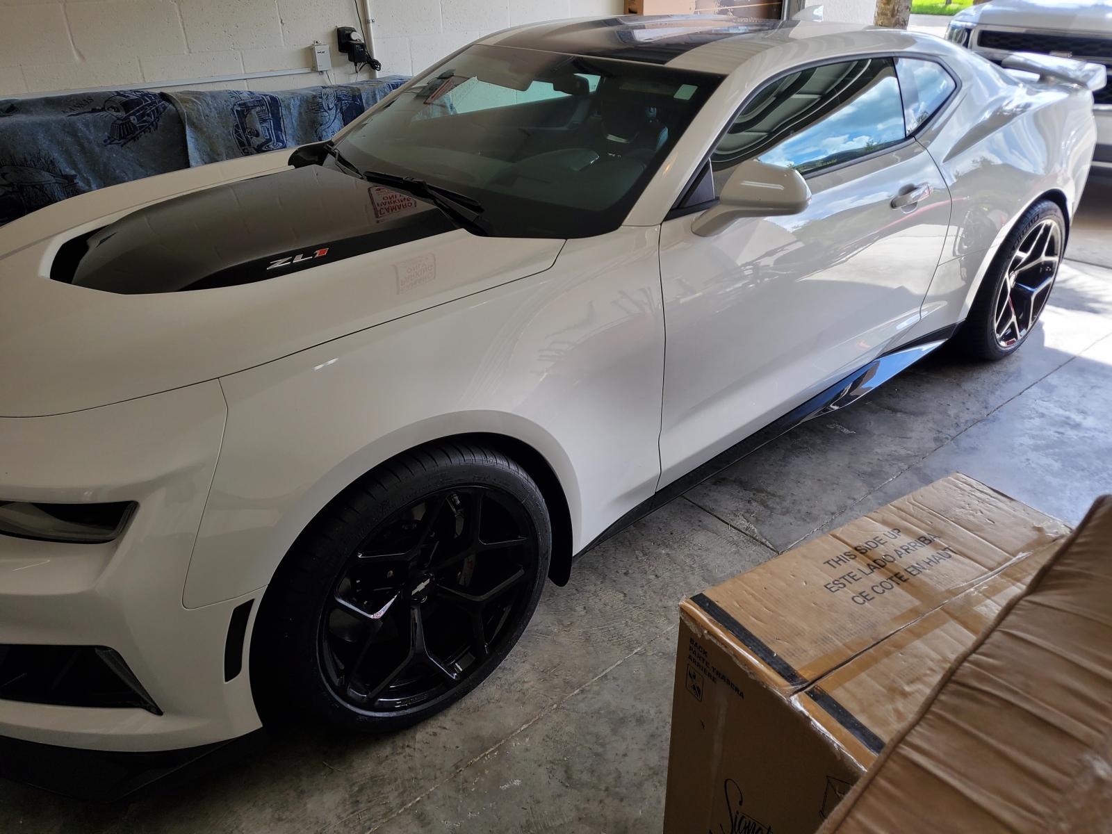

My wheels are z1le spec.
They are 19"×11 305 ft 19×12 325 rear
Bc forged mps4s
I did install 3mm spacers ft. and 5 mm back but nut necessary. Protruding is
very minimal. https://www.camaro6.com/forums/showthread.php?t=581656
