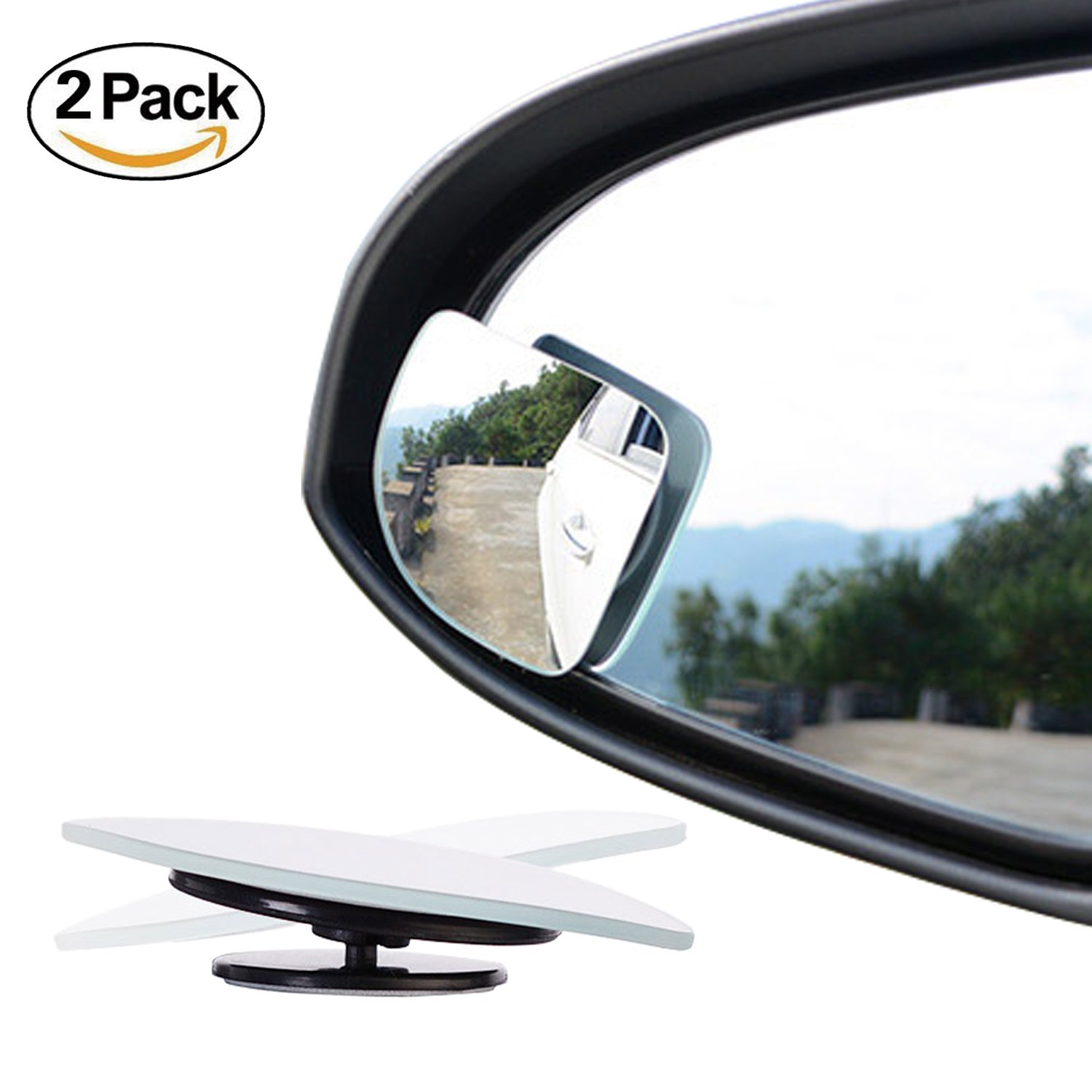

Blindspot mirrors
(simple add-on... no need for $$$ tech ... lol)
https://www.amazon.ca/Adjustabe-Ampp.../dp/B01GDQ2G4W
