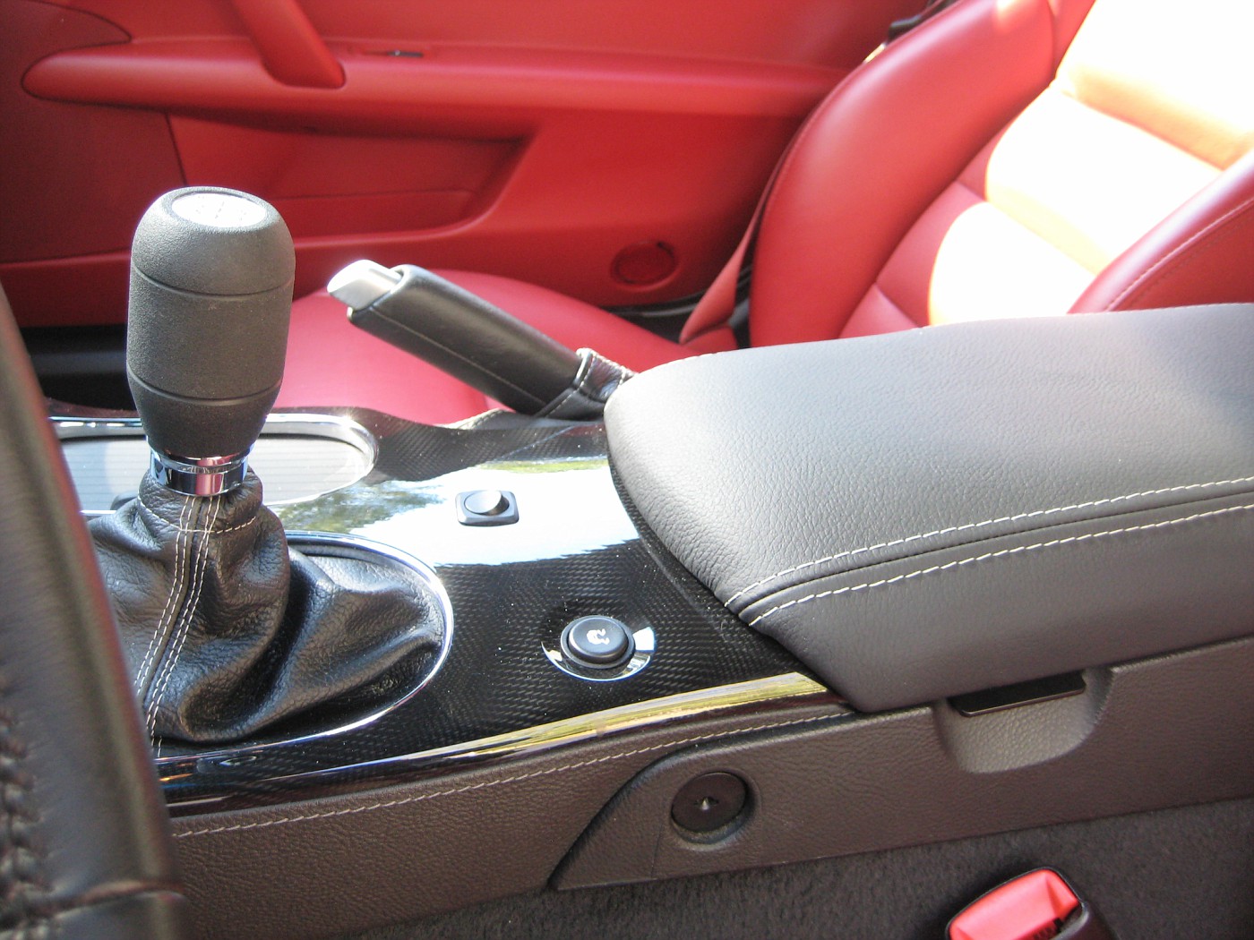

Yeah...too many switches, not enough hands! On my C6 I installed a little rocker switch right under my finger on the console. Easy on, easy off..
That's very nice! Looks factory.
