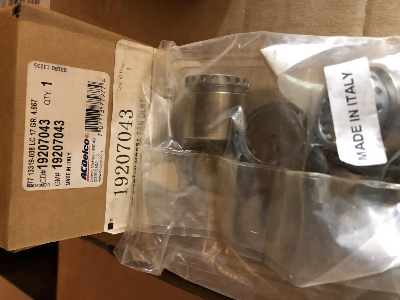

The J57 CCB vented pistons are cheap at about $115 per front caliper off Amazon if someone wants to stick them in ZL1 front calipers. Comes with the pressure seals, but, you can reuse the ones in your calipers if good. PN 23242510. Even cheaper if you have a Delco wholesale hookup like some do.
Ordered from Amazon!

I think the PN is actually 19207043. Buddy (Geoff) pointed it out to me. The pic they have for the other PN is for the vented ones, too. I will try to go correct my post. Sorry about that. Should not be an issue with returns at least for Amazon.
Updated: dug through my stash: opened the box to confirm: pic is right side up on my phone, but you can see the vented pistons and pressure seals in the sealed container.
