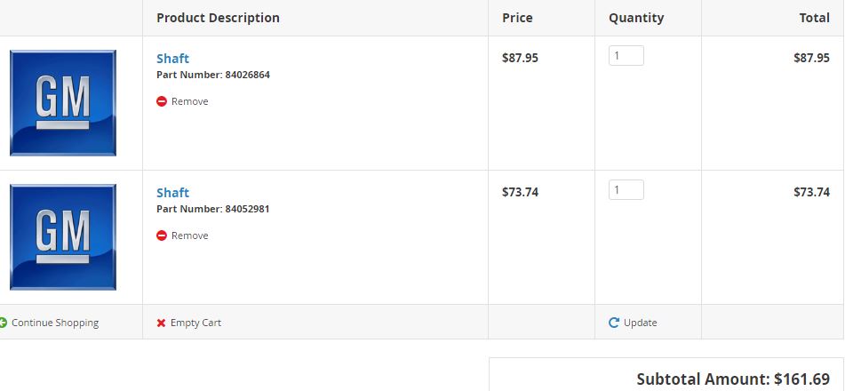

So $186.64 for front AND rear sway bar from 1LE? That sounds like a great deal. Where should I order them from? When I typed in those part numbers you provided in thatgmpartsguy.com, it just showed "shaft" and didn't have much description
Are these definitely the right part #'s for a ss? The description is disconcerting!
ps - shipping for me was around $20 from parts guy.
It wasn't always like that, seems they've shortened up the description.
In the 5th Edition of the Chevrolet Power book, it was described more completely, like "Shaft, stabilizer, front" or "Shaft, Rr Stab".
Yes your part #'s are correct. And you can bet the shipping from from the GM Direct website you're showing will be more than $20!
