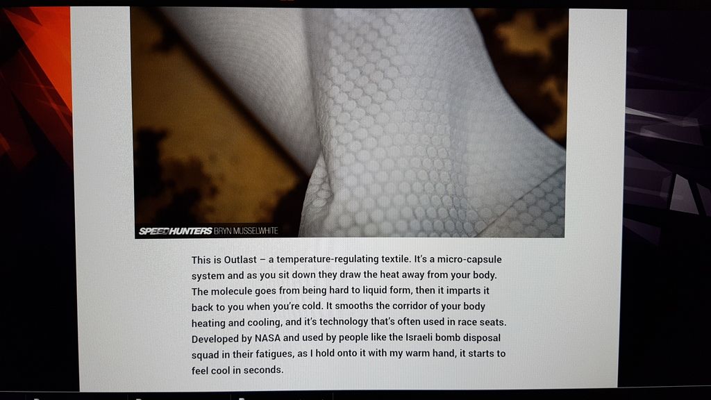

this is the NASA material embedded under the breathable Spacer Fabric that you see in the mockup.
It uses the latent heat change of state properties of a paraffin wax in sealed capsules to to either cool you down ( wax melts from solid to liquid, pulling heat from you) or warm you up ( wax turns from liquid to solid, releasing its latent heat back to you skin)
