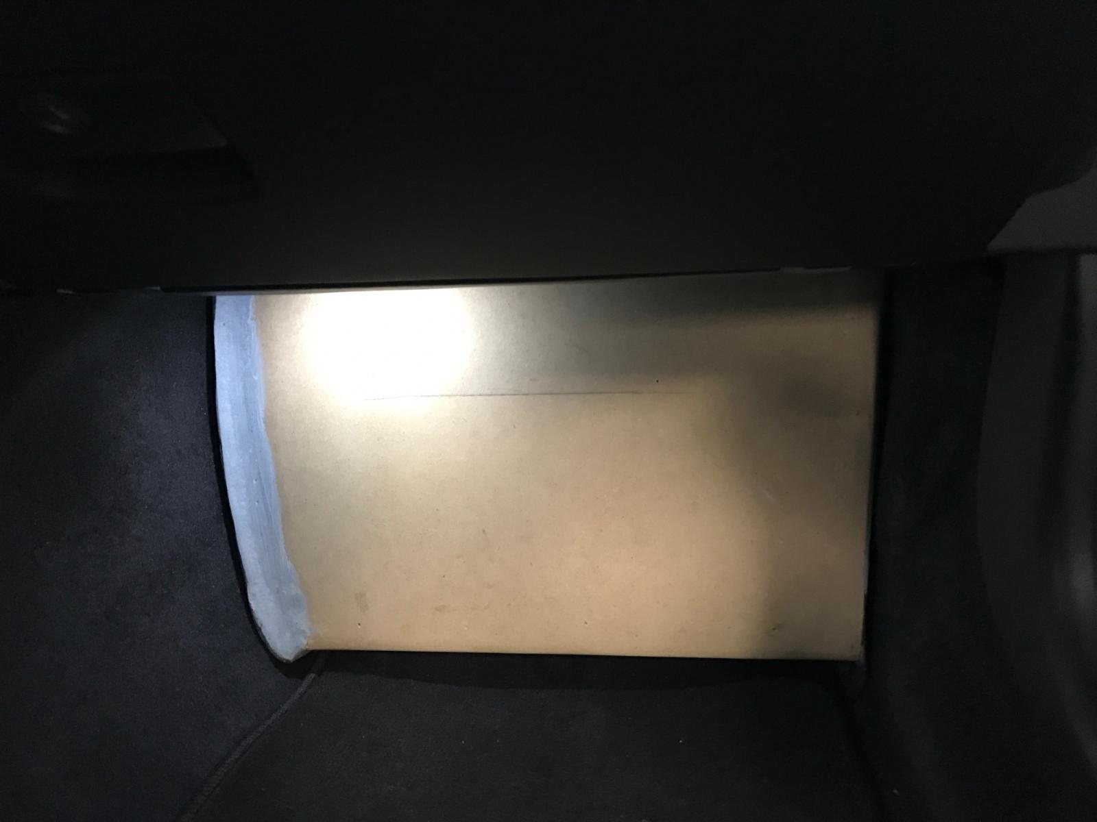

Originally Posted by MPScan View Post
2. Sub is mounted to car with some sort of holding concrete clay. I can still smell it a little in the interior. It's definitely solid with no rattles at all. Scroll back in this thread -- I think I posted a pic before the carpet was put on and you can see the clay on the left and right sides of the sub.
Is this one of the pics to which you are referring?
I did see this pic before posting my question. Is the "holding concrete clay" attached directly to the carpet? How do you remove the enclosure if you had to replace the sub?

I have a couple questions about the sub enclosure. 1) Where is the sub firing? I've looked at the pics both before and after the enclosure was carpeted and can't figure it out. 2) I saw someone else in the thread asked the question on if the sub enclosure could be removed if necessary. I never saw that question answered. Only about the clay type substance on the enclosure. Thanks!
