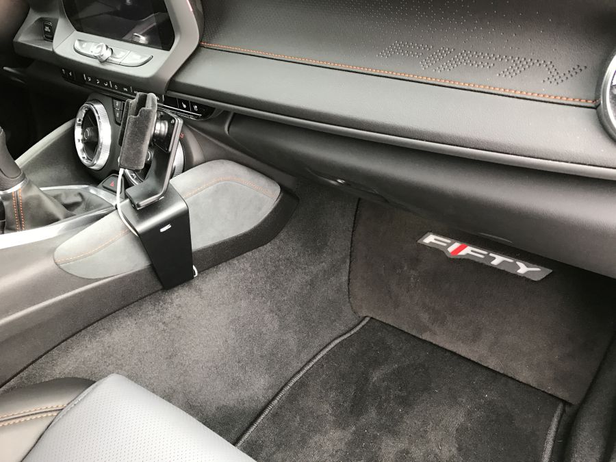

Finished install pics. The footwell enclosure was carpet matched as close as possible and the Fifty lights up in RED at night. It doesn't take up too much room at all really. Second is everything in the trunk, next to the stock amp and electronics which were kept. The Mosconi DSP (small silver box, lower right) takes everything from the Bose system after the factory amp, cleans it all up nicely, and outputs clean signals to the JL HD 900/5 amp.

Is the back-lighting of your "Fifty" logo always red, or is it synchronized to the interior color?

Originally Posted by MPScan View Post
Looks great. Just curious how the footwell sub enclosure is secured to the car? Is it easily removable if you had to access something behind it?

Wow, that set up looks great. I've got a couple questions. Why did your shop suggest keeping the Bose amp? My shop suggested removing the Bose amp and putting in a JL Audio Fix86 between the stock head unit and the new amp to give us a flat signal. I understand that's what your DSP is essentially accomplishing, but wondering why the Bose amp was kept in the equation. Second, the footwell sub enclosure looks amazing, I'm wondering if you are getting any rattles from the bass? I noticed you Dynamated the doors, did they apply Dynamat in the footwell area as well? What was used for sound deadening?

1. The FIFTY logo is only backlit in red. I have an Escort 9500 radar detector mounted under the rearview mirror that has a red display, and wound up keeping the internal LEDs on red, so I am simply going with a single color theme.
2. Sub is mounted to car with some sort of holding concrete clay. I can still smell it a little in the interior. It's definitely solid with no rattles at all. Scroll back in this thread -- I think I posted a pic before the carpet was put on and you can see the clay on the left and right sides of the sub.
