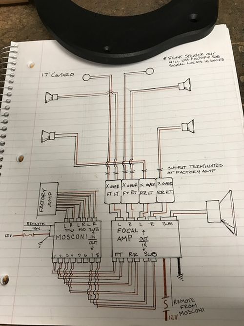

My new ride has been in the audio shop since December 28th and should be ready at the end of this week. We're doing a completely replacement of the audio system except head unit. Keeping all factory functionality by taking everything post-Bose AMP and routing it through a 6 to 8 Mosconi DSP.
It's taking a while because the sub box will be a custom foot well one (with plexiglass LED backlit "Fifty" logo in it. Also the Focal coaxials they ordered for the rear were too deep as there is no room in the rear deck with the vert so we had to go go with different rear setups.
Anyway. Here's the diagram for the setup drawn by the audio engineer (not me, lol). More pics and detailed information to follow.

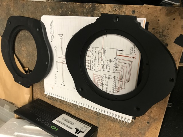

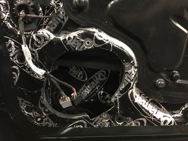

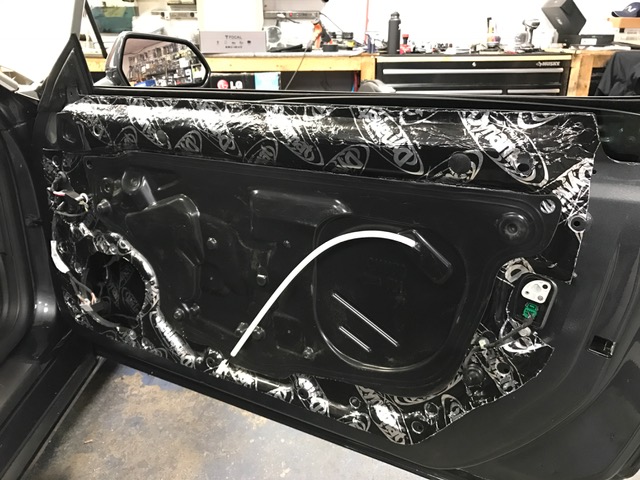

Couple more pictures as they're sending them to me from the shop. Dynamat in the doors, and the custom speaker mounts:

Old 01-03-2017, 02:12 PM   #4

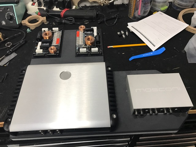

Cool. Actually he wrote "Focal Amp" on the amplifier part which was probably just a mistake. We're using a JL Audio HD900/5 to drive it all (you can see the box in a pic). The fronts will be Focal K2 Power 165KRX2 components. Will keep updated.

I was gunna say, I think you set that up backwards! Focal components and JL amps, good boy! This should sound awesome. Let us know how clean the line level converter is. Which sub are you using?

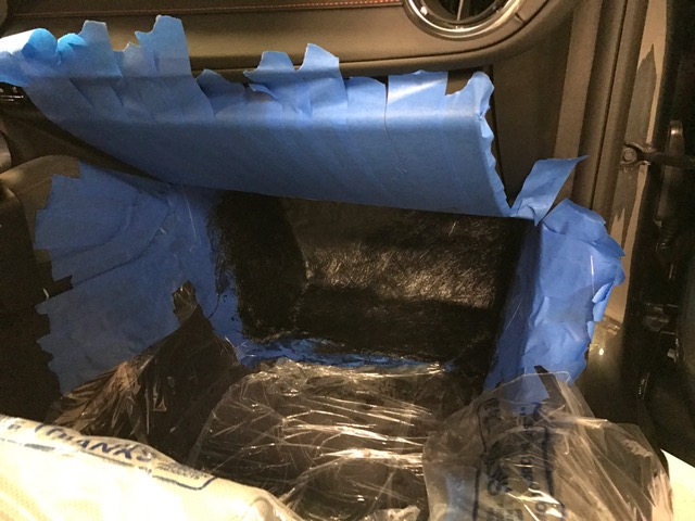

The challenge in the vert is space, obviously. Trunk sub would just push energy out the back anyway so we decided on a passenger custom foot well enclosure and a JL 10TW3-D4 for the sub itself.
The front of the enclosure will be color matched carpet, reinforced glass with the image below etched into it facing the passenger, and some LED lighting so you can see through to the sub there. There will (should) be enough room for a 6'2 person to still sit comfortably even with the room the enclosure will take up..... we'll shall see.

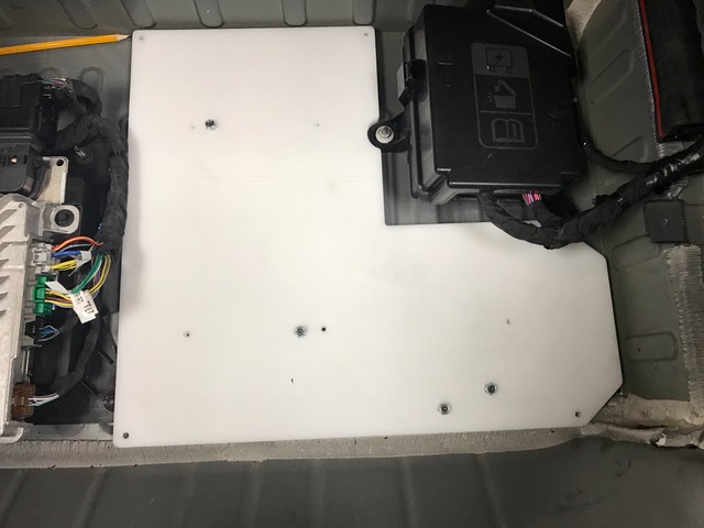

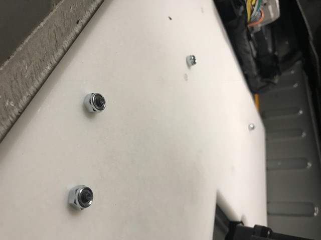

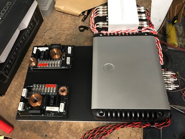

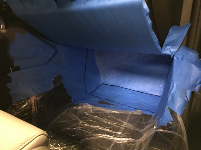

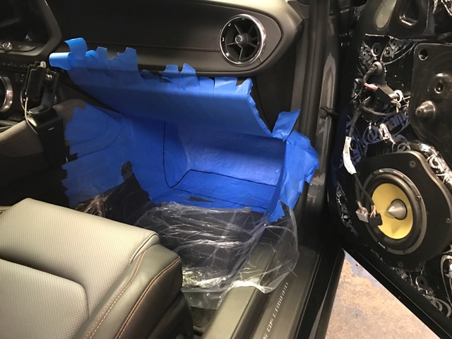

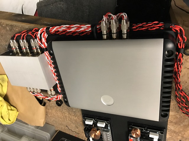

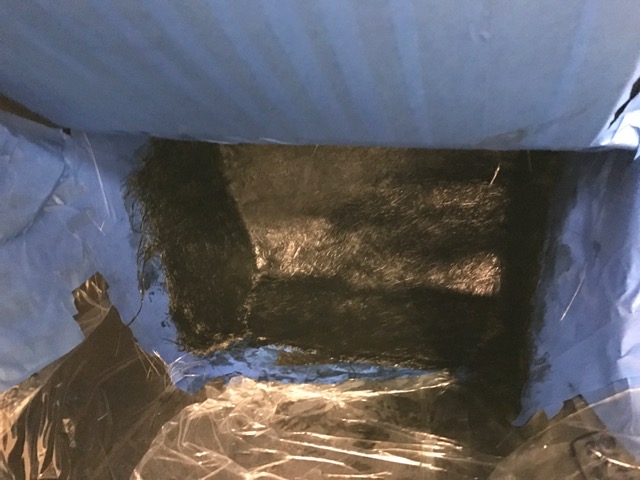

Some more pics. Custom trunk electronic mounting platform. Foot well prep for the woofer. Mounted electronics for the trunk.
