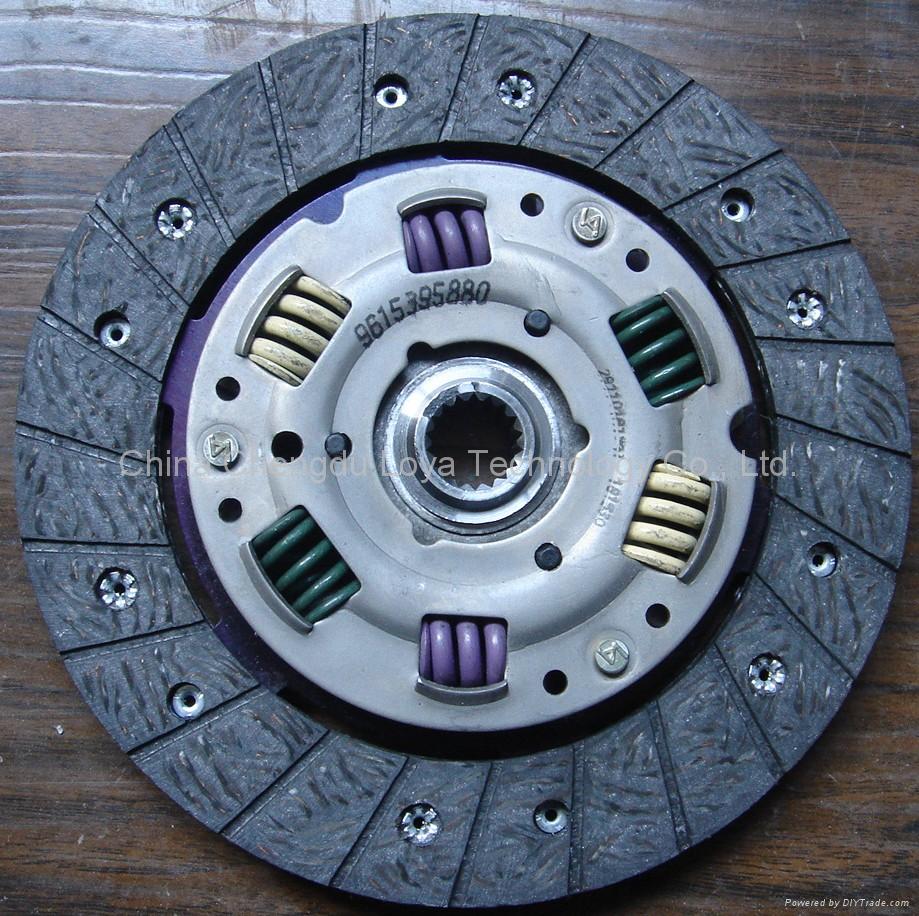

Originally Posted by Quiksilver16ss View Post
Sounds good. What about the push in clutch in first gear at low speed rattle??!!
The only thing I can think this is is that the clutch plate has springs in it. When you are in first gear and put allot of torque to the wheels they depress, or if you let off the gas and the engine is strongly slowing the car they depress the other way. The purpose is to keep the car more smooth. If you suddenly let the clutch out they will snap back and forth making a "Tack tack tack tack" sound. It happens every day backing up my inclined driveway.
Here is a random clutch disc picture showing the springs:
