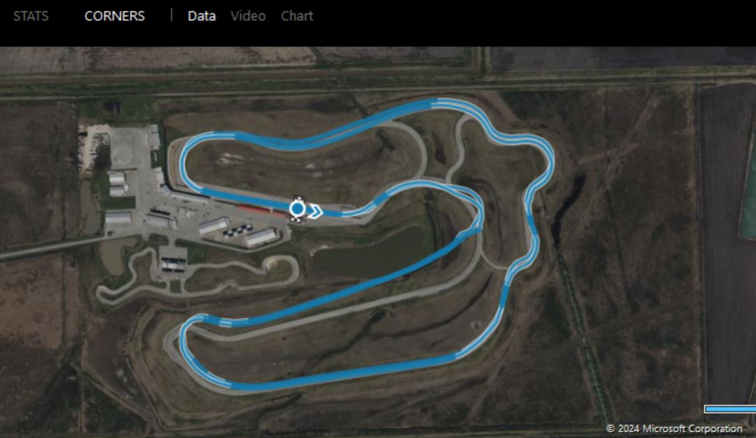

Reporting in on this thread.
I have a ‘23 1SS 1LE. The PDR has not worked correctly since new. I’ve done 10 track days with it and I will usually see the symptoms as described above. Works for the initial session, but then the track map goes spaghetti and the times either dont record or the whole session is lumped into one lap time. Sometimes the data shows correctly in Cosworth toolbox, but this is not always the case. This leads me to believe it may be how the car is displaying the data I’ve been using micro center SD cards, class 10. Been using an individual SD card for each track.

I have been working with a group of GM Engineers. There will be a TSB soon to cover this, which involves replacing the existing Antenna with a new unit and moving it's location to in or near the shark fin.
In the meantime, I have found a replacement GPS antenna that I routed to the rear deck until the TSB is available that has 100% cured my issue.
GPS Antenna - Amazon

Well, I finally got around to making this video. I wanted to test it out first on my own car, before making a video for others. It works, and it's a solution to the funky GPS antenna until GM releases their TSB for the 22-24 models.
