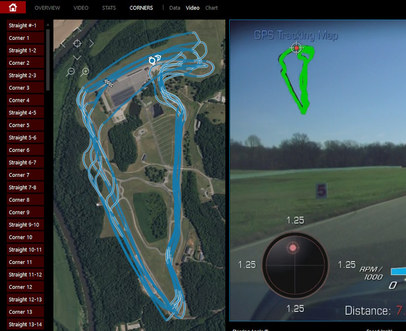

I tracked my 23 ZL1 yesterday for the first time. PDR was acting crazy! GPS had my Map overlay all over the place. Sometimes it would finish a lap and restart Timer, but mostly it just made the session 1 continuous lap. Very dissapointing! I tried redefining the finish line before 2 other sessions and it did not help.
Attached Photos of Heartland Park map and what my overlay looked like
travislambert is offline   Reply With Quote

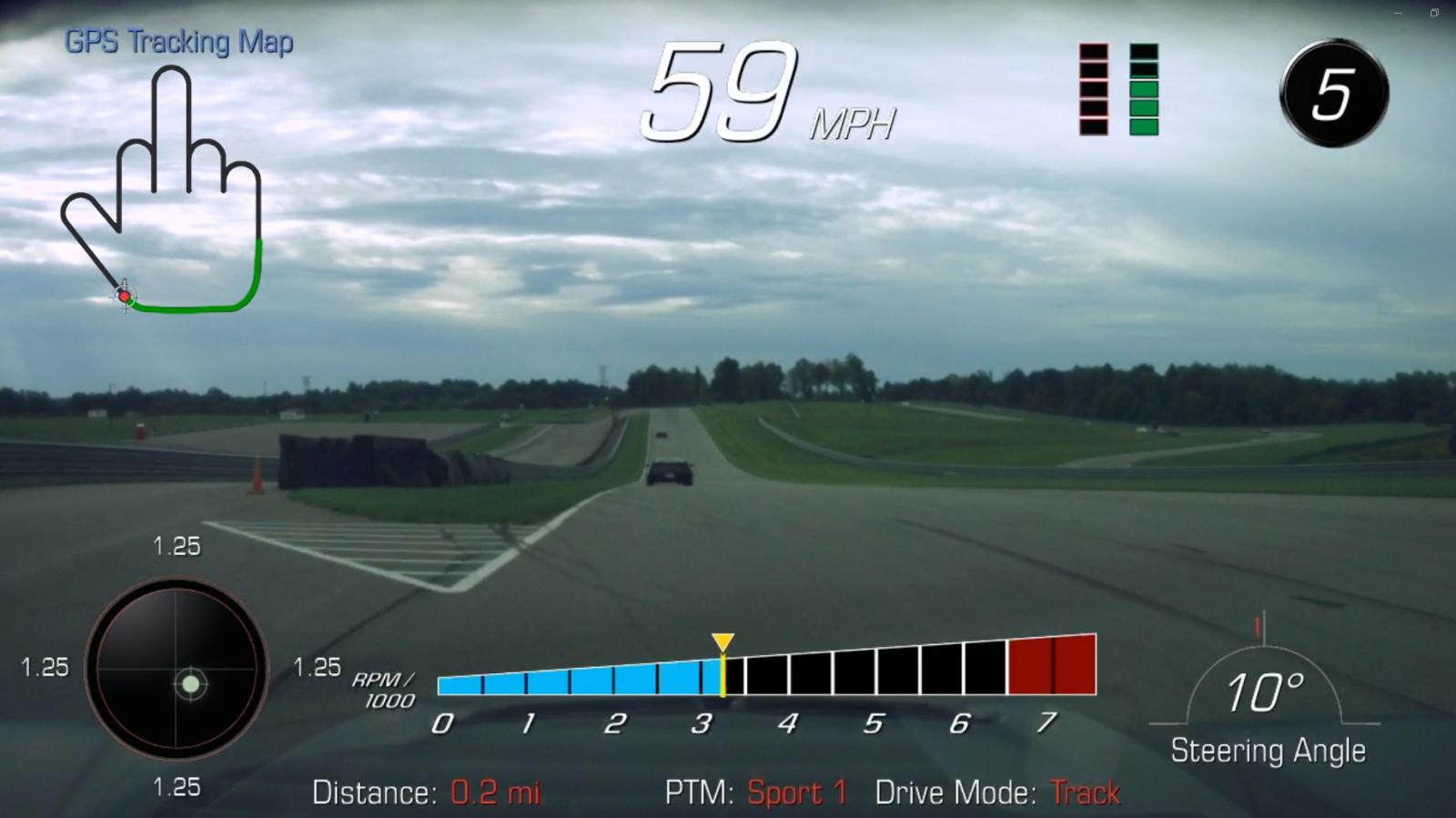

I thought mine worked yesterday, but when I looked closely, the map wasn't accurate.
Old 09-23-2023, 09:29 AM   #13
Posts: 13,149
Attachment 1136978
Yeah, those 180˚ left turns look pretty tricky.
