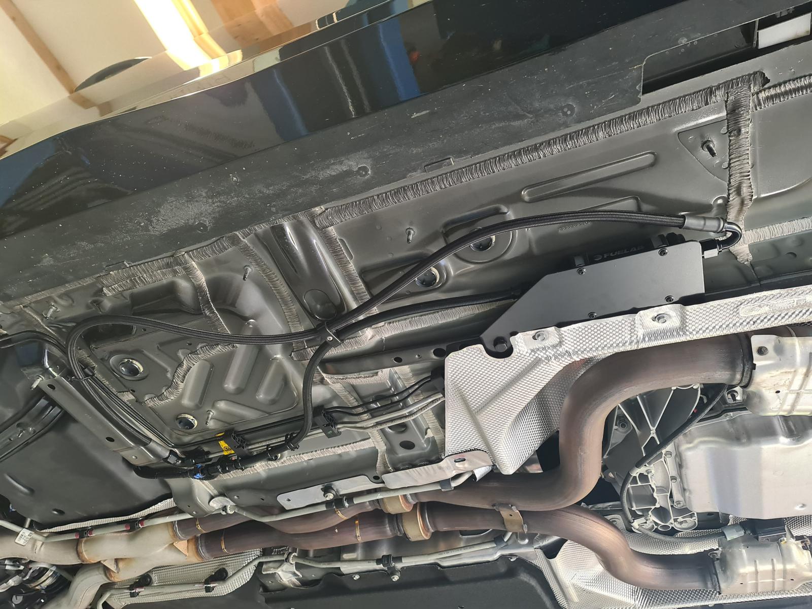

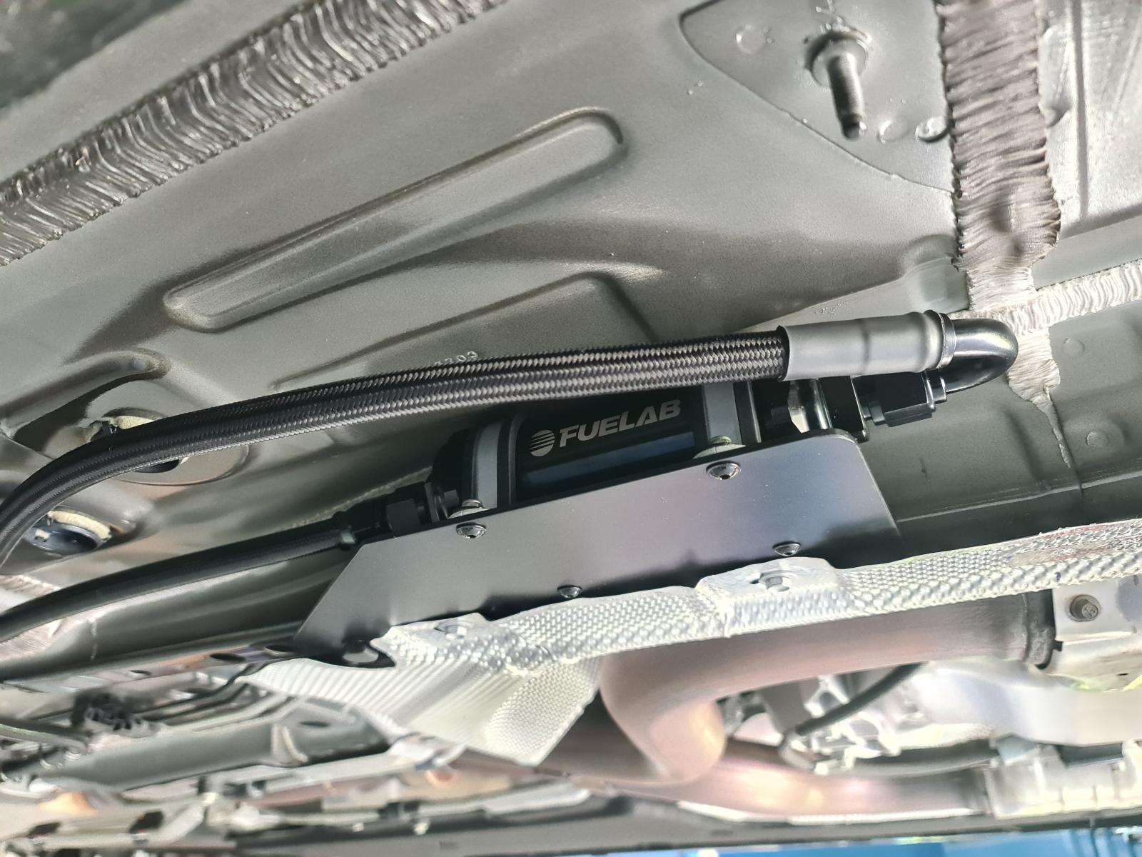

Finally finished my fuel filter setup!
Had to drop the tank twice due to a potential issue with the DSX pump, and then had to wait forever for one last fitting to show up. But it’s all buttoned up now.
Went with a Fuelab filter mounted under the car, happy with how it turned out.
Here are a few pics of the final setup:

So after letting the car idle on the lift for about 15–20 minutes, I noticed the Fuelab filter gets really hot, way hotter than expected. Even though I mounted it away from the engine bay to avoid that heat, it seems like the underbody area is getting heat-soaked from the exhaust and cat right underneath. The whole floor panel in that area gets warm.
I’m now thinking about cutting a few vent holes into the front part of the underbody panel to let some airflow in while driving. Also looking into adding some heat shielding around the filter and maybe isolating the bracket a bit since it’s aluminum and could be conducting heat into the filter too.
Would be interesting to know, has anyone else noticed the same issue?
@Gabe your setup looks super clean also! Would love to see what your thermal camera shows in that area after a drive. I’m sure you’ve already got a smart fix figured out..

Hey buddy, thats some great feedback... because the fuel filter is now covered, it's more work to check that temp, but I will and report back. I did heat sleeve all of the lines for just that reason.
