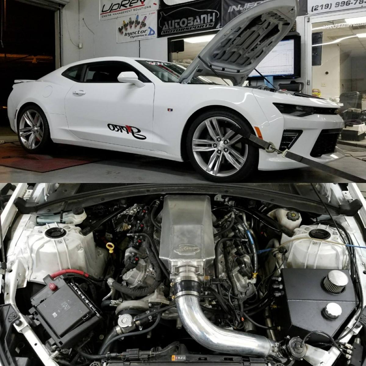

I build a custom catch can/breather and water resivor/overflow tank. Won't work with procharger cars (if I can find a local with a procharger i can design and build one that will work with procharger)
for vents,
I pull the valve covers off and press out the pressed in fittings, i then drill out slightly and tap with 1/2" npt to use a nice an fitting on -10. Both valve covers vented and the pcv vented to the tank. The ugly plastic oil seperator behind the water pump I pull out and i take the drain tube out of the oil pan, I then cut it down and weld it and re install it just to keep the pan sealed off.
Heater lines can easily be ran back but I live in Houston Tx and don't need any of that stuff lmao. I will add them back in later it starts getting foggy windshields and get tired of wiping them down with a towel I'm sure.
