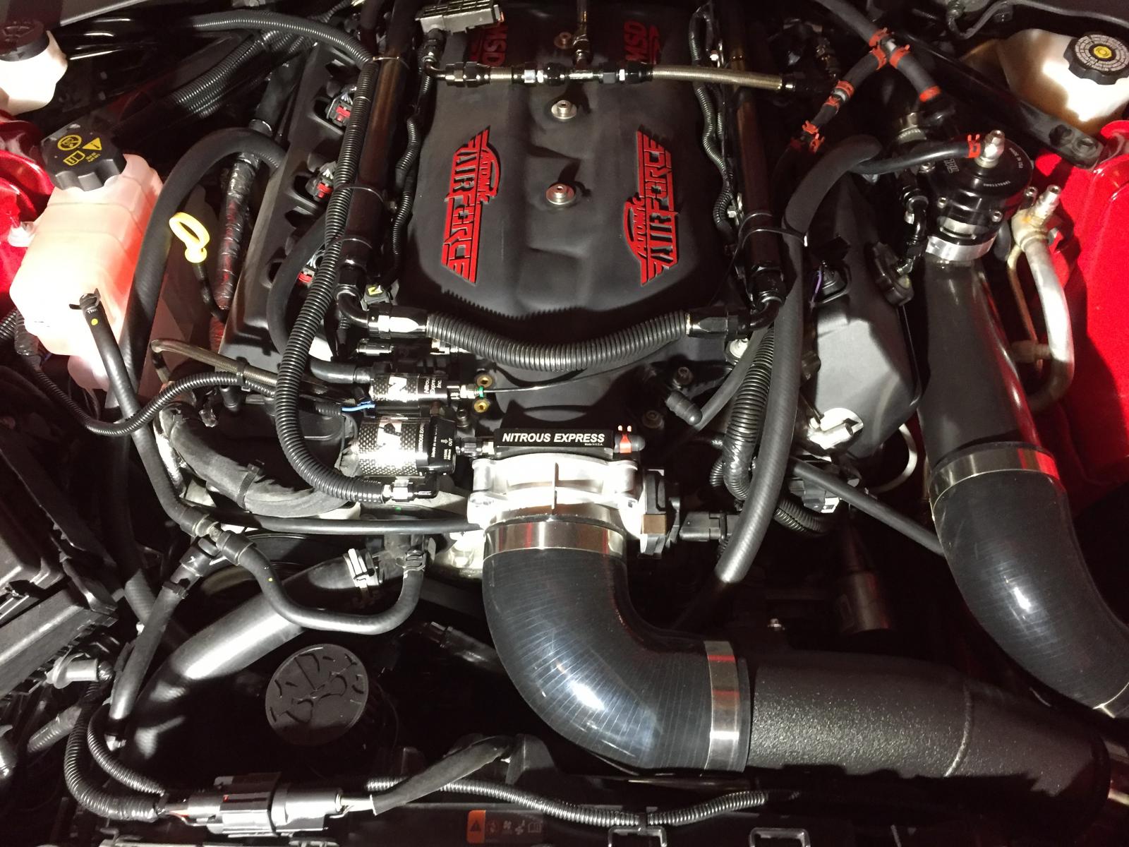

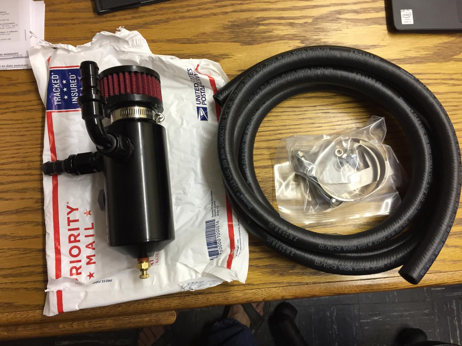

For more serious builds I prefer a simple breather/catch can set up and change the oil more often. I am running a 5/8" hose from each valve cover to a mighymouse race catch can. I recently leaned you can replace the stock low tension crank seal with a normal crank seal from an ls3.

looks good and clean!
