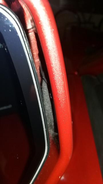

Old 10-22-2017, 10:23 PM   #77
Posts: 13,429
The same thing is happening with my driver side mirror, a hissing and gurgling sound appearing at 40-41 mph and present all the way up from there, with very slightly varying intensity depending on actual speed. Not overly annoying, but clearly perceptible.
Now I have a wild little idea, though. When taking a look inside the mirror, I noticed a cable sheath hanging loose behind the glass and visible between it and the mirror body, only on the driver side, the passenger side mirror is fine with nothing visible in the gap (and, not coincidentally IMO, it emits no noise). So I reached in with a thin vinyl trim remover and shoved the wire behind the glass, just as an experiment. Lo and behold, no wind noise for two days... then today I began hearing the same whizzing, and sure enough, the darn wire is back where it used to be, see the picture.
I'm not sure about all this, it is a long shot given the shape of the mirror and the noise pitch, the actual reason could well be some air gap between the mirror body and the door panel due to inadequately torqued bolts or something else, but I tucked the wire away yet again nevertheless. I'll see if this fixes it at least temporarily, and if yes, I'll remove the glass (when I feel brave enough) and strap the cable down permanently. The mirror doesn't feel loose at all and I see no gap anywhere btw.
Just wanted to throw it out there in case it might help someone.

I know most of us are out of warranty at this point, but for anyone who is still affected by this issue, here is the solution that worked for me.
First off, the turbulent "whistling" noise is not normal. I have a 2017 2SS that is in great shape, but it had this persistent noise at about 45MPH+. They replaced the weather-stripping under warranty, and while it helped (pushing it to 55MPH), it didn't completely fix the issue. I brought it in several other times and was repeatedly told that the technicians either 1) could not hear it or 2) said it was normal.
Eventually I ended up talking directly with one of the techs, and while he was able to hear it, he wasn't 100% confident that it was repairable. Luckily they had a 2018 1LT on the used lot. We went over to it, and it had a ton of miles and was in far worse shape than mine. We took it for a test drive, and there was no whistle on either side. If this car with triple the miles and in worse shape than mine didn't have it, there should be absolutely no reason that mine did.
He wasn't entirely convinced that it was the mirror housing, so we tried the painter's tape method to figure out where the noise was actually coming from. We taped everything from the small black triangle by the window to the weather-stripping to the door's panel gaps. Almost all of them turned up negative, but eventually we found that by taping the front of the mirror housing, the noise went away.
It seemed as though the noise was coming from the small gap between the mirror itself and the housing. We tried reinstalling the glass, looking inside the housing for anything that was out of place, and putting thin adhesive foam behind the glass, but nothing worked. I had heard somewhere that it could be the angle of the mirror housing itself, so we tried reinstalling the housing a few times (some just bolting it back on and some trying to force it at a slightly different angle). None of this worked, and it ended up making the noise even louder and more noticeable (you could hear it at about 35MPH+ instead of 45-55).
After all of this, we tried putting on a brand new mirror housing that was paint-matched to the car. This worked. Since the new housing was installed, I have not heard the whistling noise once. I don't know why putting a new housing on fixed my issue, but I didn't really want to mess with it.
-- TL;DR --
The solution my dealership and I came to was to replace the driver's side mirror housing, and so far, it has completely fixed the issue.
