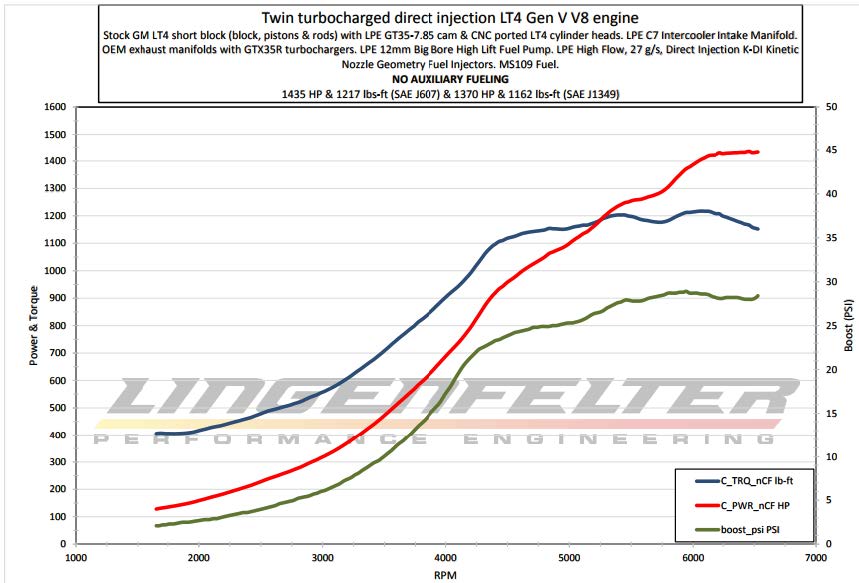

Even CM's super hot 232 / 250 which is for a max effort 6.2 is VASTLY smaller than the cam you are looking at. The only thing that you matched is the your engine size, which is really a secondary consideration, as a smaller engine can be spun higher.
Ligenfelter is making over 1400 HP on their GT35 cam
https://www.lingenfelter.com/mm5/gra...20Kit%20v1.jpg
Specifications: intake/exhaust
Duration @ .050 valve lift 210 / 237
Lift with 1.8 rocker .640 .650 LSA 116.5
6.5 mm fuel pump lobe
If you are Joe Normal and this a pump gas ride, I'd look at there two
226/242
or
230 / 246
I don't like lift so mine is sub .600 your valvetrain life will and may vary. Oh and you better have some serious springs in that bad boy if you want to do standard lift .650 and over 7000 RPM, checkum change um every 20K miles, inconel valves (or titanium). I like the conical springs myself. As NOTHING on the stock valvetrain is usable IMO.
https://www.compcams.com/conical-val...2-at1-170.html
Just an example I have no idea which one will work for your inconel / titanium valve, titanium retainer setup.
I like the NK844 stuff:https://www.lsxceleration.com/manley...alves-12352-8/
I like this as it is solid, the factory LT4 titanium is great and all, but at some point with valve bounce and abuse a solid valve of similar strength material (way heavier) is going to be better, just realize it is going to take even more spring to control it, at least the head is undercut slightly.
Inconel for the exhaust
https://www.lingenfelter.com/product...l#.XiJNXshKguU
