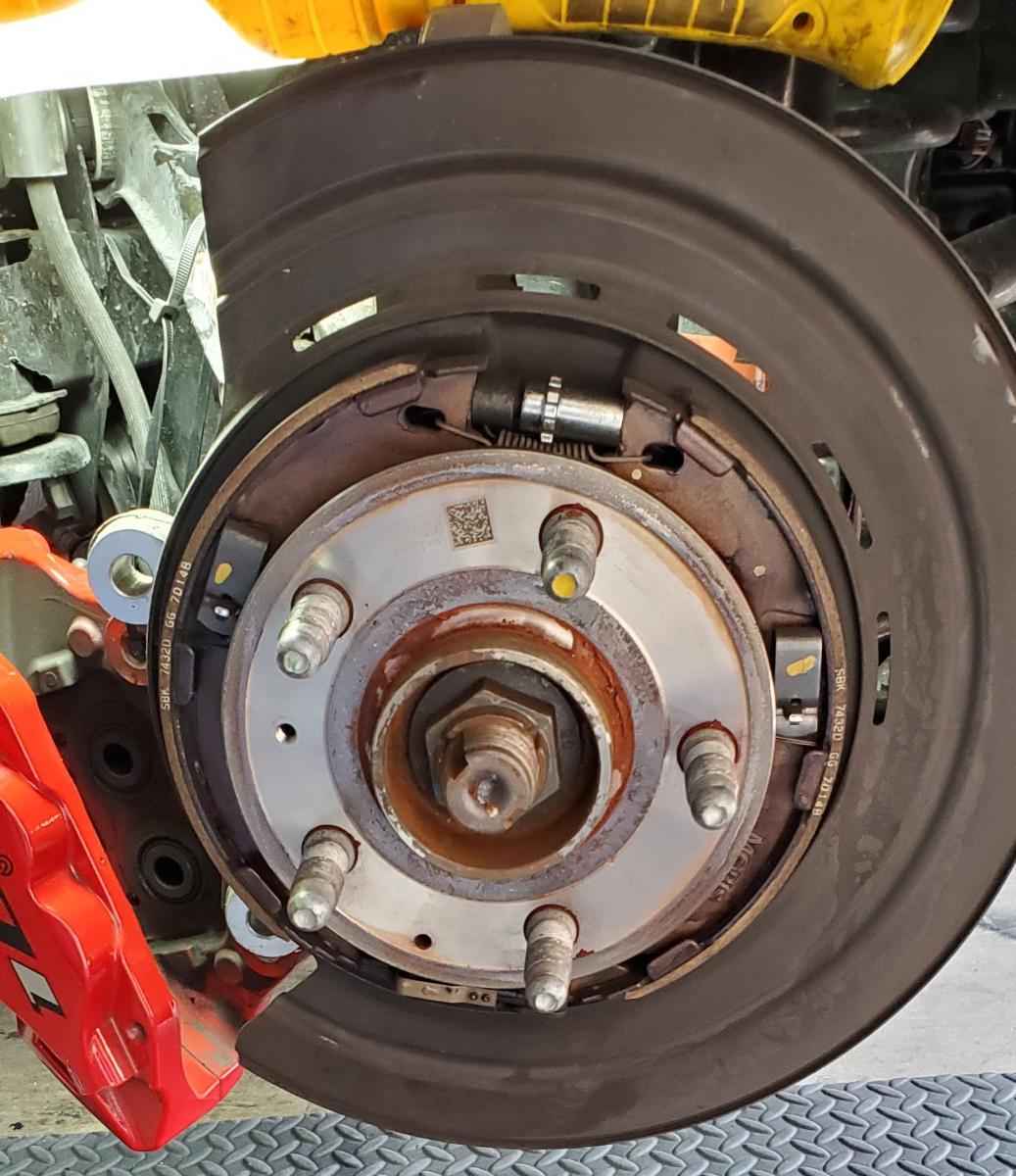

Ken at KNS was talking about doing a 2 piece rear floating rotor but cost for the pair for was like 1K. The other issue on the rear of the SS anyway has a full diameter splash shield that would need to be cut down to the minimum and still protect vital parts, similar to the SS track kit for the front.

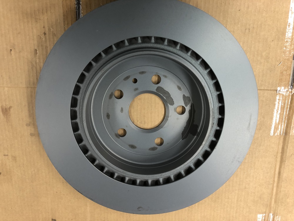

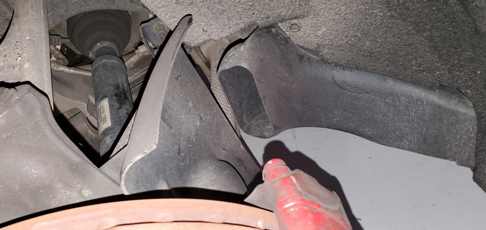

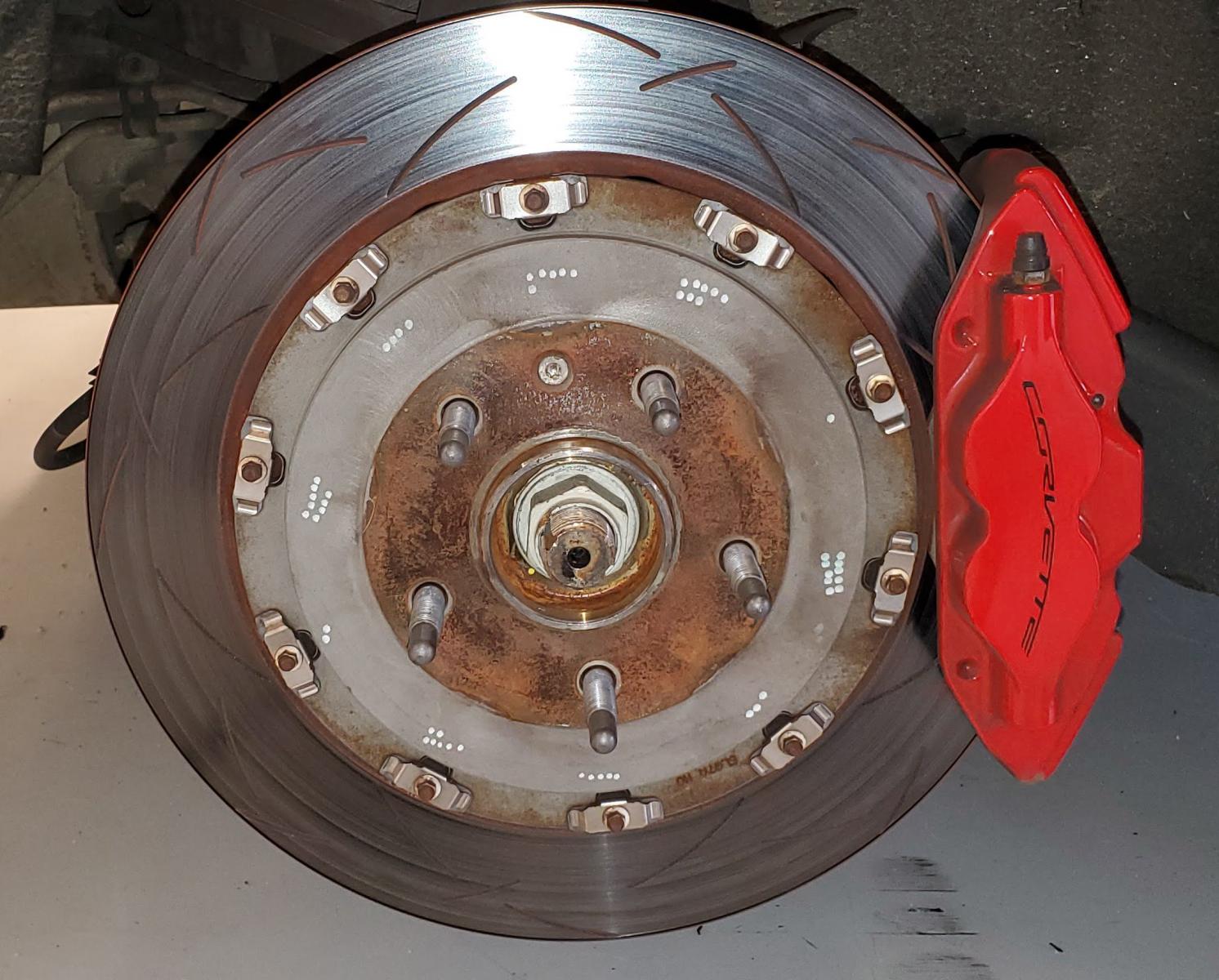

These pictures show the rear of a C7 Grandsport 2 piece rotors and rear duct cooling. We could use these rotors on the SS but the hat is not the right size. (Bottom picture is rotating 180 no matter what I do)

The J6M rear SS 1LE rotor is 340mm and the J56 C7Z / GS steel rear is 365mm with 12mm stud holes with a steel 2-piece hat. That rotor is the same OD as the one-piece Gen 6 ZL1 J6H rear rotor.
Mine are already cut everywhere that there isn't a suspension bushing.

All brakes will get hot, by design. But ive never heard of rear calipers going "Brownbos" no matter what pad, suggesting cooling is not an issue per se. Personally, I'd rather spend $ on different components.

Originally Posted by RUQWIKR View Post
The ZL1 rear rotor, like SS 1LE, are one-piece vented with drum-in-hat e-brake.
Right, but from looking at pictures it seems the venting comes from the inboard side not the outboard side like the SS.

Air does flow from the rear of the rotor
If you wanted to open up the slots in the dust shield as shown in carguy55's photo, perhaps more cooling. I haven't heat cracked a rear rotor, yet. To paraphrase TrackClub, if it ain't broke don't fix it
