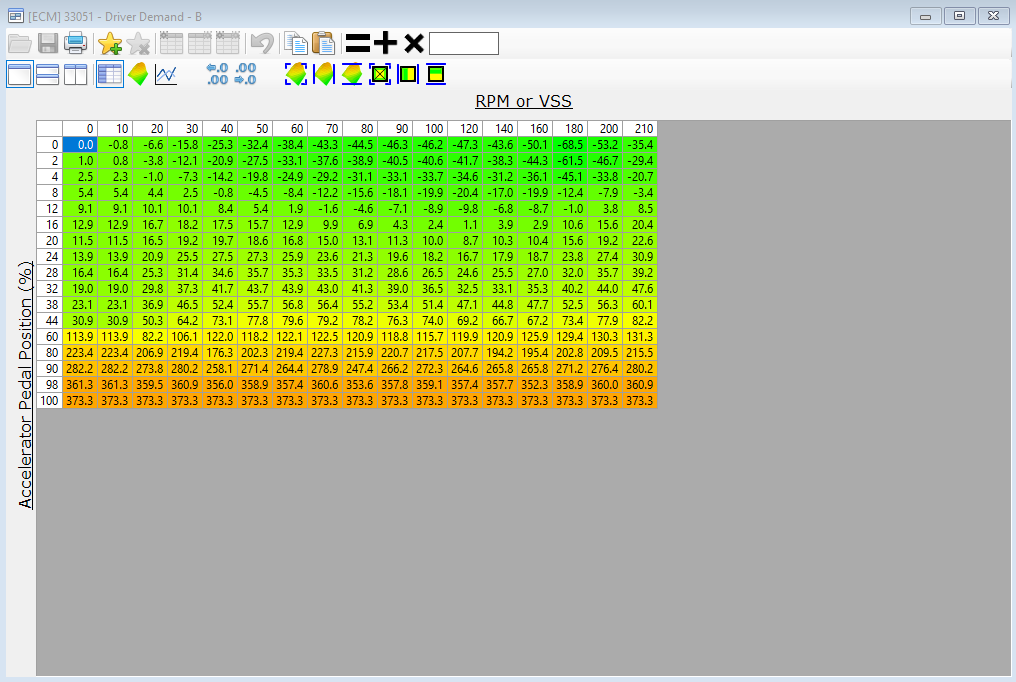

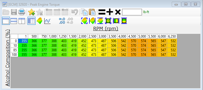

How much would you change the torque management or the peak torque in hp tuners? I've attached both screenshots. Thank you
