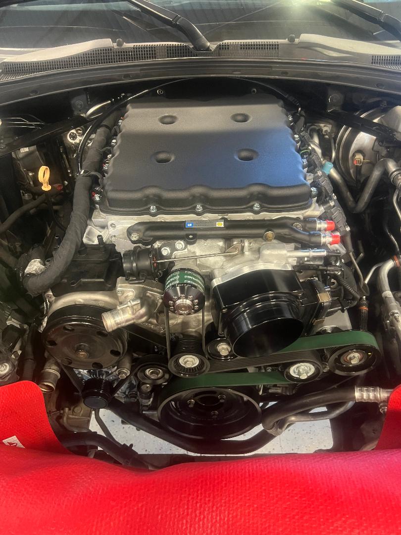

I will get you the specs on that because I thought they were going to run a FORE TRIPLE setup but apparently they are NOT.
Here is PIC of engine it its new home.

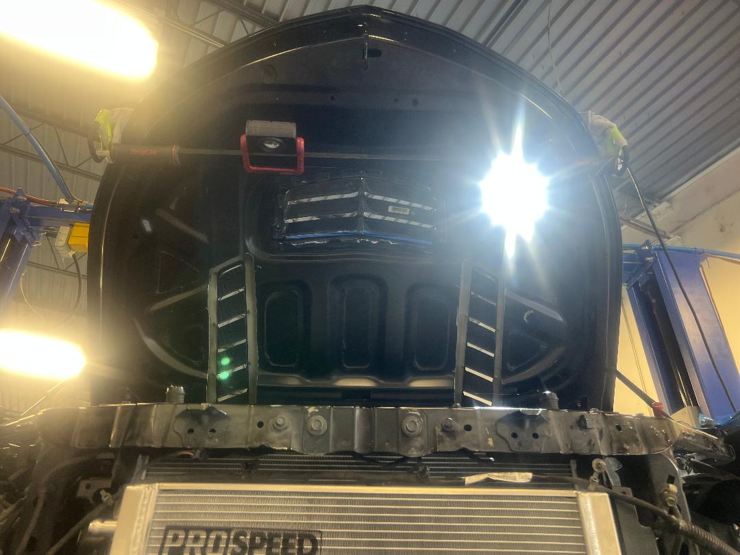

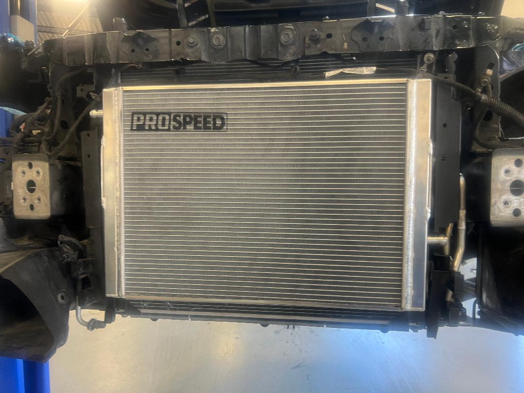

Fueling is being handled by stock ZL1 fuel pump and injectors. 38% fuel lobe is being utilized on a Crawford Racing custom spec cam. The LOW SIDE fuel system is being augmented by A DSX external fuel pump.
A LARGE heat exchanger is being used (see pic) to help alleviate heat soak issues. It is a PROSPEED unit that is 22 inches wide and15 inches tall and about 2 ˝ inches thick.

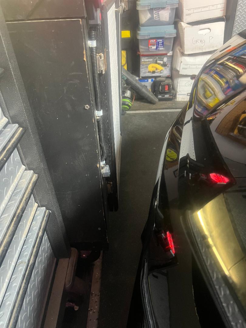

OK so today, I installed a Garage Stoplight so that I wont constantly have to be worried about EXACTLY where the front end chin spoiler is in relation to my workbench that sits on the back wall of my garage. Here is a short YOUTUBE video below on how it works. You can pick up one of these at HOME DEPOT for about 32 dollars.
https://youtube.com/shorts/6ZGTmcandvo?feature=share
The picture below gives you a view on how everything is set up on my workbench. You can see the sensor that is below the light that gauges how close my bumper is and THAT's what controls the light. In this specific instance, the sensor will bounce an ultrasonic wave off my bumper bar.
Link to get more details:
