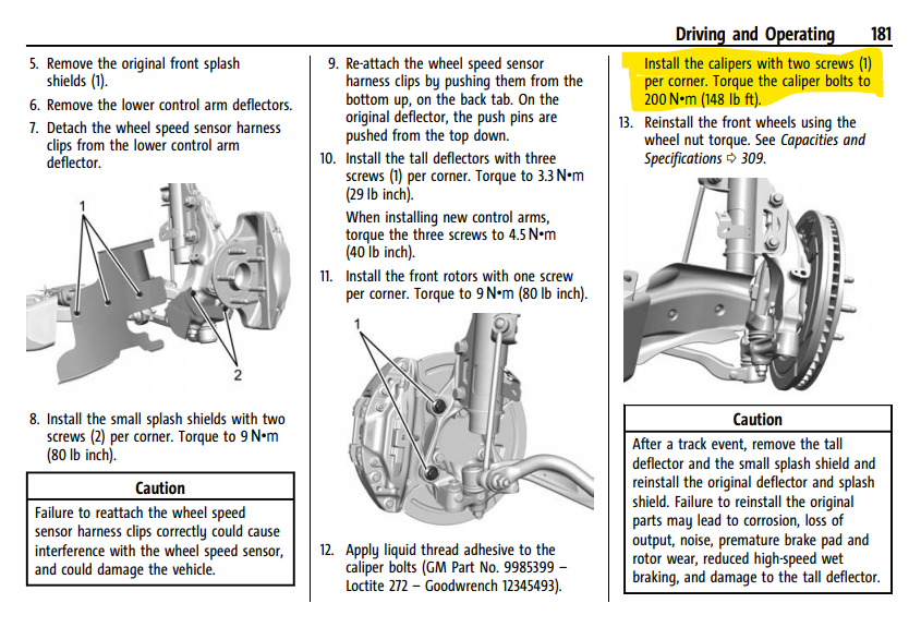

Caliper Torque Specs confusion
Page 181 on my owners manual says that the Caliper should be tightened to 148 FT Lbs
That is way off from most of the videos and local shop that say 111 ft lbs
and then the internet at
For the 2023 Camaro ZL1, the brake caliper mounting bolts should be tightened to 40 N·m (30 lb ft) + an additional 90 degrees of turn
What is everyone thoughts on this?
what do you tighten your calipers at?
148 ft lbs seems like a lot

My manual has J6M 111ft lb and 15-30 degrees. J55 is also 111/15-30. I just did mine and I ended up buying a tap 14x2 to clean up the threads because the bolts wanted to cross thread half way in. So 148 is probably about right for end value.

either spec will hold the caliper on. the thread locker will keep it from backing off. in my opinion the 111 will be less likely to start trying to pull the threads out of the knuckle over time or several brake jobs later. but me personally i just hit them with and impact and put the wheel on. ive never had a brake bolt try and back off and ive never had a customer come back because their caliper has come loose.

In my manual all the specs for 6 piston brembos, BCD, J6M and J6H all call for 111 ft lbs and 15-30 degrees. Blue loctite they are not going anywhere. I also remember reading somewhere, it might be in the manual not to use an impact on aluminum calipers.
