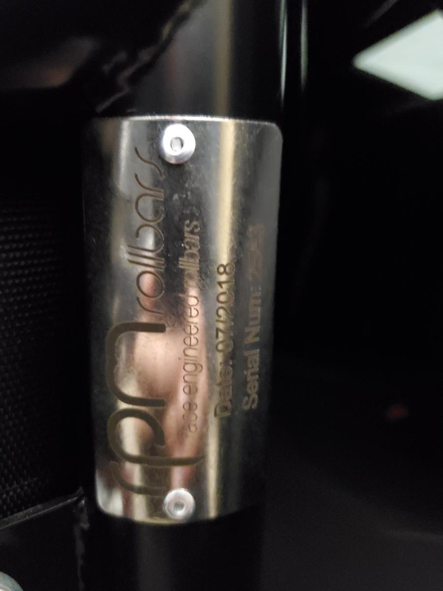

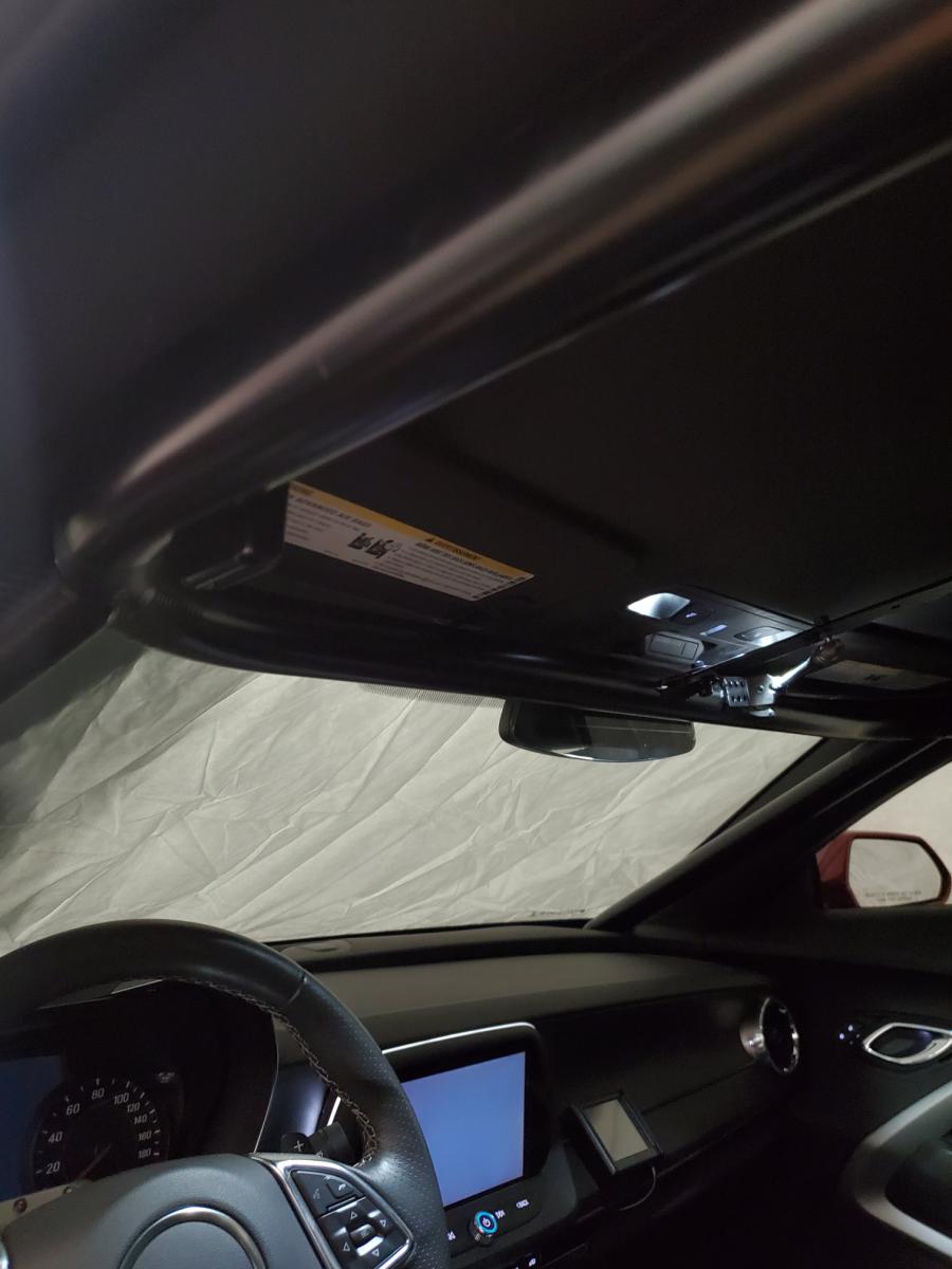

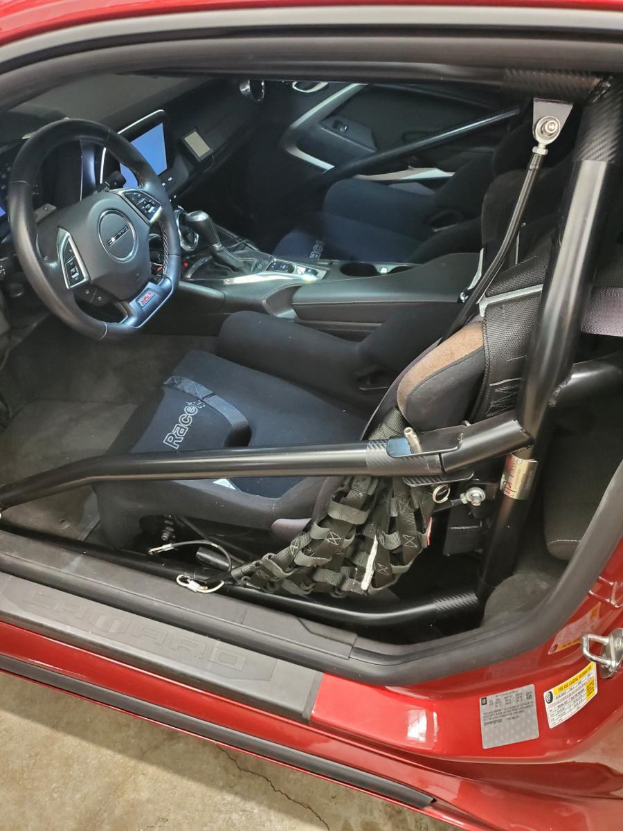

Roll Cage
Here's a few pics of my 8.50 cage on my 16 Camaro. Few other things to keep in mind. You will also need a window net and a parachute after 150mph. My cage is a 8.50 cert RPM and is fully welded in. It's not that bad getting in and out once you get use to it. The 16 Camaro has alot less chassis flex then my 18 Camaro with no cage. The rear view mirror and sun visors are useless.

That looks good! I bet that bar that goes thru the dash up front is a major PITA to install! I would think the dash would have to be removed?

Agreed, probably pull the windshield to do that.
