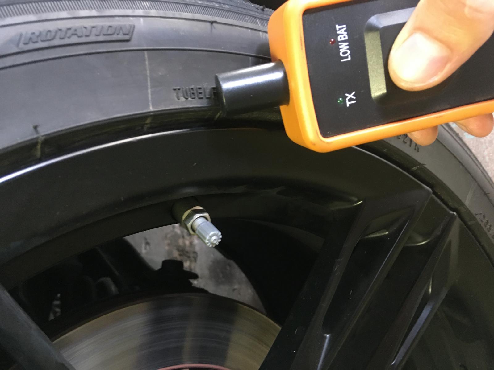

  5. 5. To learn a TPMS, place the TPMS learn tool antenna on the tire sidewall, as near to the tire bead/tire-to-wheel split as possible. You may need to either point the TPMS tool antenna in, toward where there TPMS would be (the actual sensor part) or with the antenna point upwards (yes, UP, toward the sky, but against the tire sidewall). You may need to repeat the TPMS learning, all together, if you can't complete the TPMS relearn on a particular wheel, and play with TPMS/valve stem position - the best positions seems to be 3-to-5-o'clock or 7-to-9-o'clock.
    For a brand new sensor, it seems that "waking up" the sensor can be a little temperamental. You may need to release air [fairly rapidly] while attempting TPMS learning with the tool. The TPMS may not learn at the attempt and may require a fresh, normal TPMS learn, starting from the beginning.*
  6. 6. Once you complete the LR TPMS learn, you will get a single horn beep, as with all the other three wheel position, but then there will be a short pause, followed by a double-beep, which will confirm the TPMS learn was completed for all four wheels and accepted.
*For the two, new front TPMS, my RF simply require the TPMS position to be at the 7-to-8-o'clock position. My LF required the TPMS to be positioned at 4-to-5-o'clock (it would not work at 7-to-8-o'clock) and me to attempt TPMS learning, while letting out air and activating the TPMS tool. I did not get the TPMS to directly activate, I had to re-start the entire TPMS learning and the TPMS was learned right away. My LF, RF and RR TPMS would learn with the TPMS tool antenna pointed at/toward the TPMS sensor, where my LR TPMS seemed to like the TPMS antenna point UP.

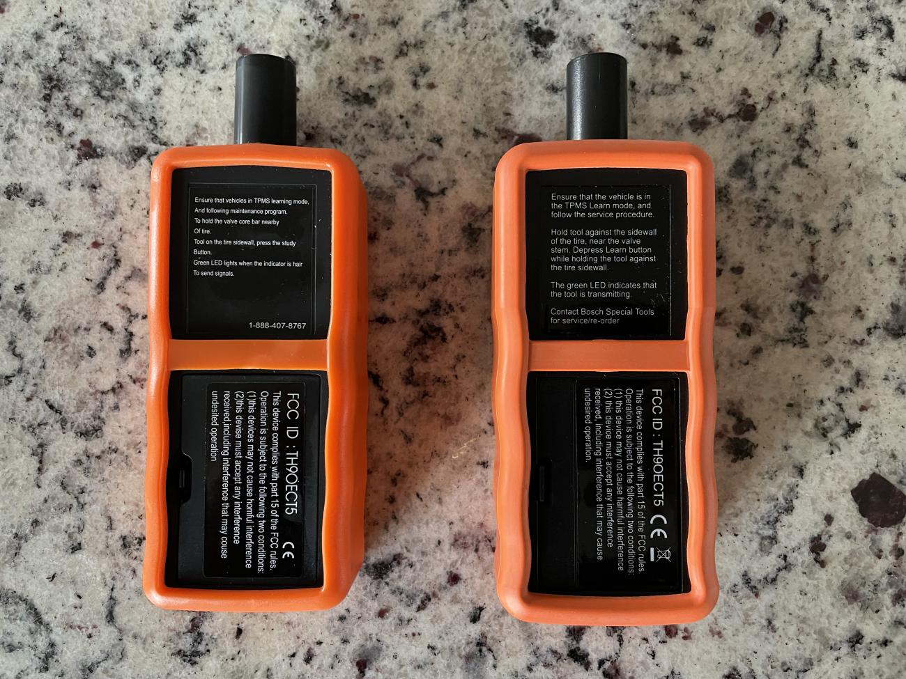

I tried to position the sensors as described and was able to get the front two to acknowledge but timed out at the first rears. New realization came when I started over and the front wouldn’t connect even though they had been woken. The TPMS acknowledged previously so why not immediately when I tried again. They were woken.
I bought a new sync tool this year because I couldn’t find (remodel house) the one I’ve owned and used twice a year since 2016. The old one synced immediately each of the nine times I changed the tires.
I looked up the manufacture of the two tools. The one I just bought, and doesn’t work for shit, was made by Shenshengyi and cost $12.65
The previous one, that worked flawlessly, was manufactured by Bosch for GM, and cost $88.63
The problem I had here is the cheap tool.
I bought a new Bosch tool and the sensors acknowledged and synced immediately even with the low battery flashing because I use an old battery
https://www.autotoolworld.com/Kent-M..._p_198848.html
The Bosch tool is on the right. It is larger and the orange surround is soft. Throw the other POS in the trash and buy a new Bosch unit
