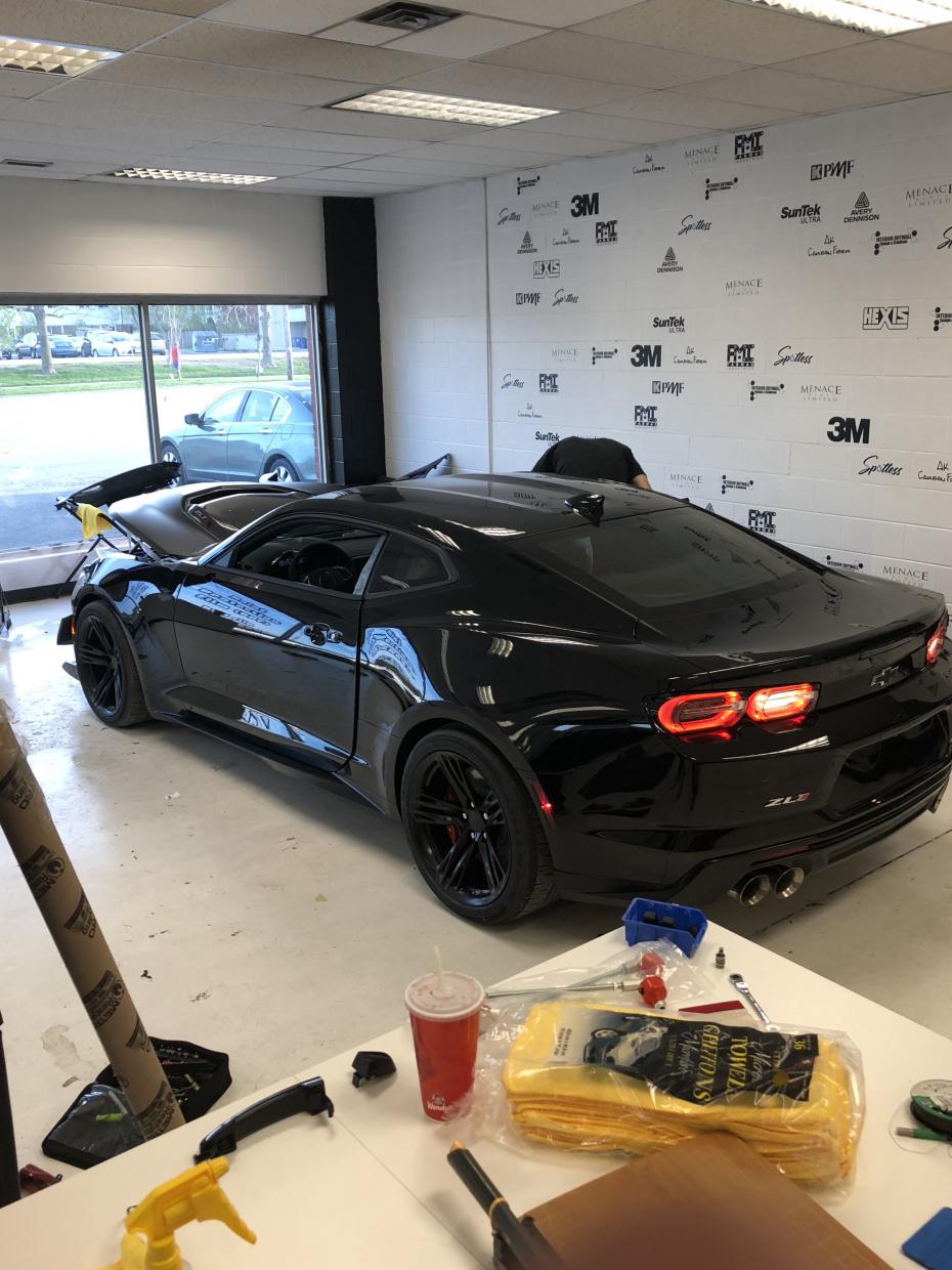

Here’s a pic

Couple more.

I thought the car looked pretty sinister without the wing.
