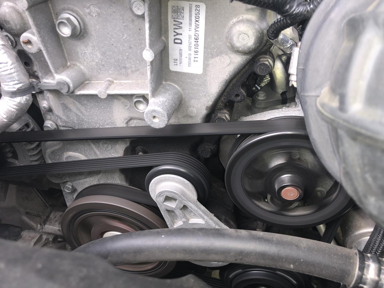

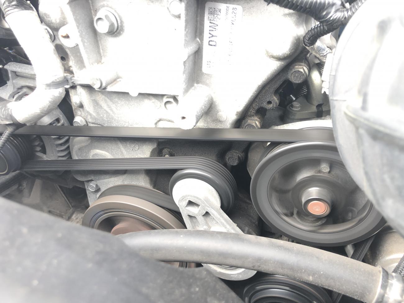

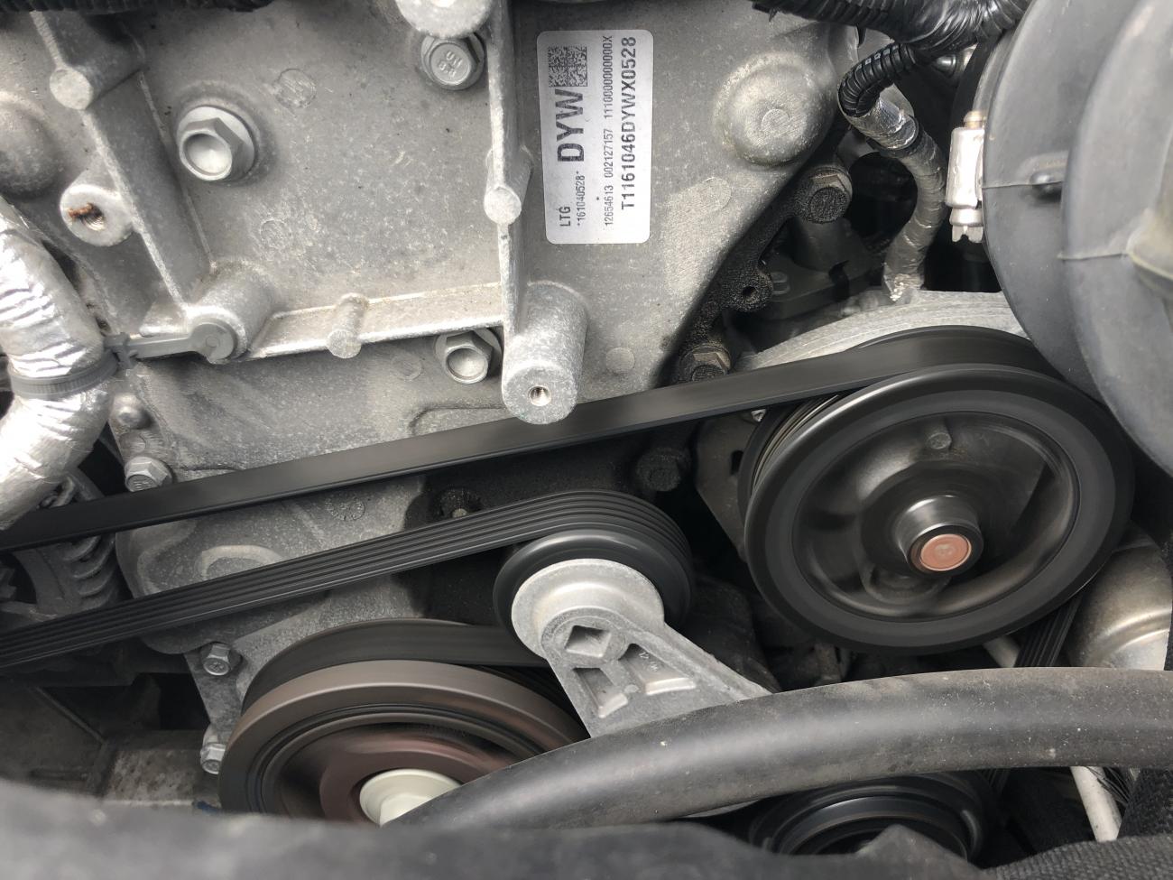

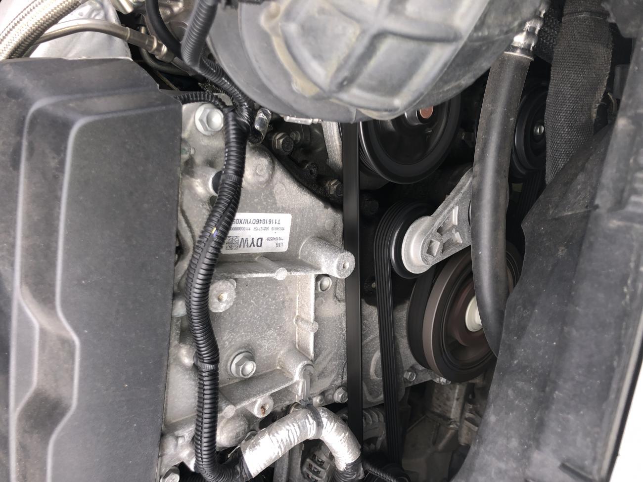

Hi Guys,
My 2016 Camaro with LTG engine is coming up on the end of its power train warranty and I would like to get any issues fixed before I can’t any more.
At the front of the engine I noticed an oil spot, right under where the pulleys for the belts are. I’m attaching pictures.
I’m about to take the car into the dealership but I don’t want to have a chance of them NOT covering this under a power train warranty.
My question is; is what I’m seeing normal? Should I be concerned or just let it be?

It is normal, oil seep is infamous for making a new engine look like an old one. but you should make them replace the timing cover gasket anyway.

Either way you should get it fixed. It's not where it's ending up but where it's leaking from next to belts and pulleys. Still a seep but as a consumar you have the right to request it he fixed under warranty. Go for a long trip look at that middle empty bolt hole where it's leaking if it looks like a greasy oil it's the gasket not seated or completed possibly because of shiity manufacturing/factory install or from seep causing seperation. I notice this more in the winter because of condensation.

Meh... Looks like standard seepage. Do an under car inspection after idling for a while and check for actual leaks. Could pressure wash first too. If you are not losing oil between oil changes meh. I'd be more concerned with diff seals and oil/water in the intercooler if you are not catch canned
