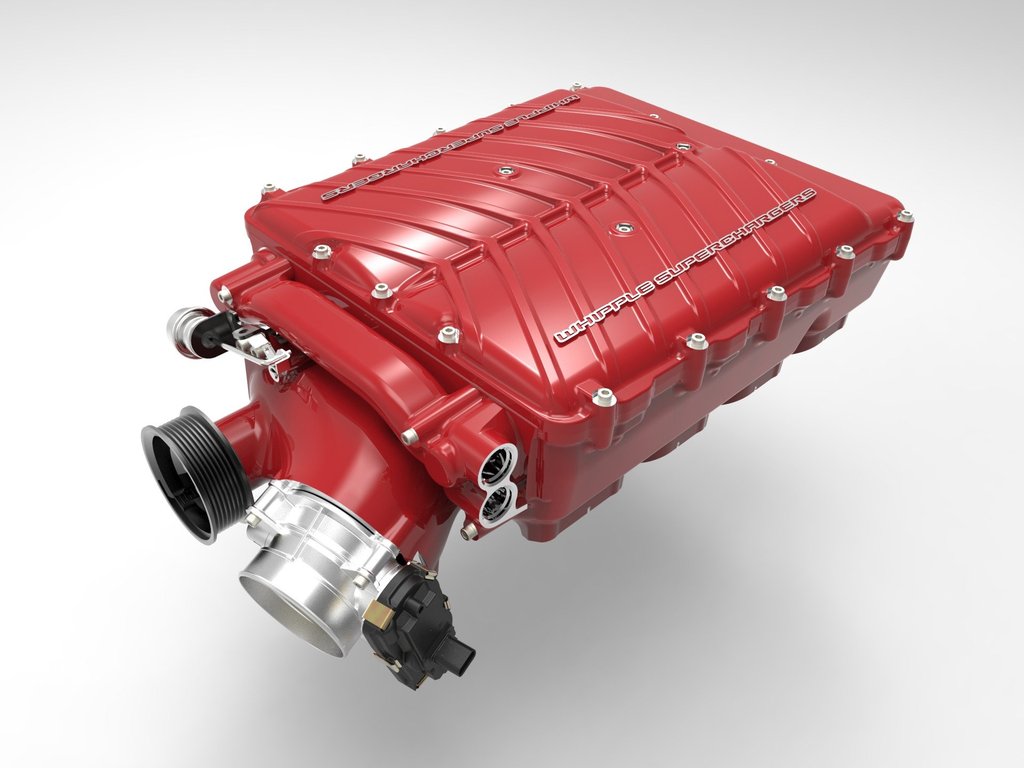

Whipple Supercharger - Upgrade Fuel System or not?
Hello everyone,
Trying to see who has installed a whipple supercharger without upgrading to the LT4's injectors and high pressure pump vs one WITH upgraded injectors and HPP... And would love get feed back from you - likes, deslikes??
I am aware that our cars are limited due to not having forged pistons. I would like to NOT get into the internals for right now, and stay within the limits. I hear different numbers on that - is it 600 hp (ish) to the wheels??
I have a '17 SS 1LE and debating on whether I should just go for the LT4's upgrades right now or later (OR ever?)
Not a big racer, more for street driving, and love the car as is BUT want MORE POWER just because...
Thanks in advance!
