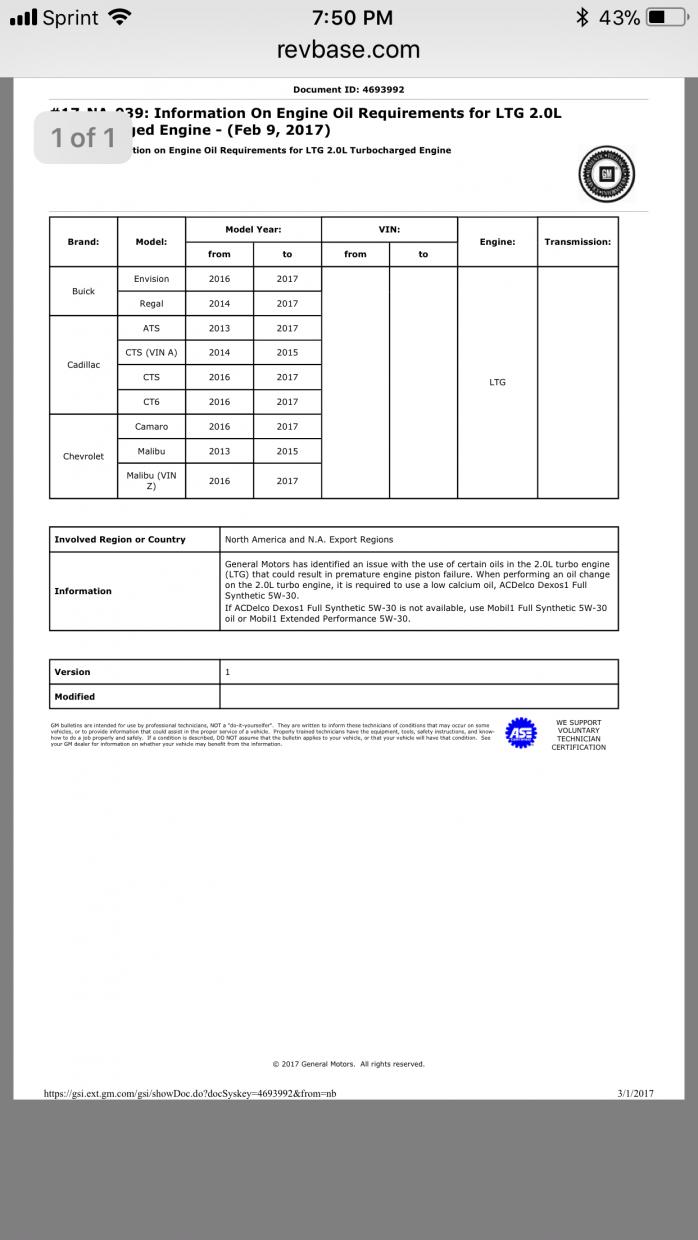

Old 01-11-2018, 01:37 PM   #2
Evil-Bee-NH
603 Camaros
Evil-Bee-NH's Avatar
Drives: 2017 NGM I4 1LT Coupe
Location: Manchester, NH
Posts: 6,779
Tiger Blood

we use mobil 1 ESP on our performance LTG's/LNF's. it is a low ash oil, which helps prevent carbon deposits, and in turn, prevents pre-ignition (part of what was killing the early LTG engines)

Thanks guys! Nice that I've got the owners manual on my phone now.
I was specifically wanting to see what xW40 oils can be used.
Owners manual recommend 5w40 Valvoline synpower MST or Mobil1 15w50.
Currently I'm using Rotella T6 0w40 and will send in a sample for UOA once I do an oil change.
Zzsteve you may wanna see if mobil1 changed their additive pack if and when they switched from CJ4 to CK4 certification. I likely won't be using RT6 with the new CK4 formulation.
I had a UOA done on the AC Delco full syn 5w30 and my engine is looking just fine at 45000 km.
