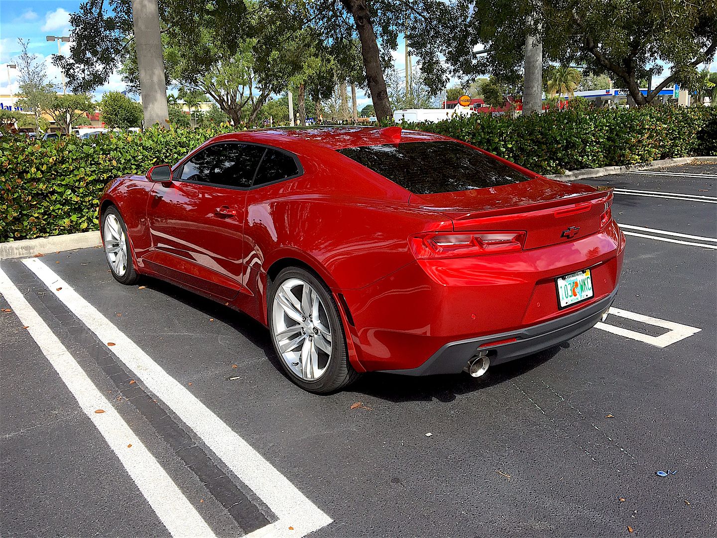

REJEX is a good product. But Now you can get the same product, that does not need a haze buff off - blackfire Crystal seal is one - watch this:
http://youtu.be/q3u4x3oLtBU
And mine looks like this, after a 20 min application:
Click on the docs in my signature , read #1-4 in order
