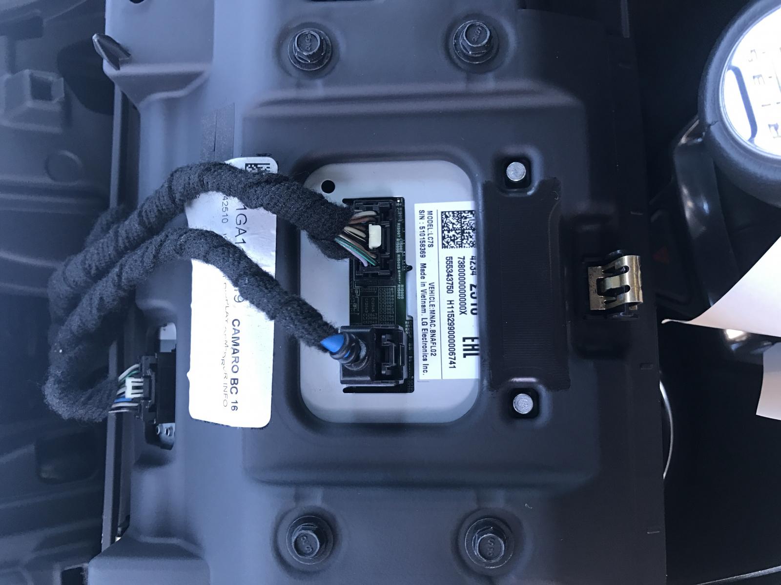

I know how to remove the 7" Display, but i need more info on connecting the wires and such. First of all, MUST you install the iO5 receiver for the display to work? Secondly, does the 7" Display have the same connectors as the 8" Display? If not, can I just buy the harnesses from a place like gmpartshouse? Will it be plug and play? The more info given, the better, so please help! I installed the bose speakers so I DO in fact want to install the iO5 or maybe even iO6

Post a pic of the wires that go into your 7" and I can look at my 8" to see at least if the connectors are a direct fit. It's only 2 plugs back there. Your hmi module might be a issue.

Here it is, except it's upside down

I can tell the main plug in, not the mini usb plug is in a different location. Can't tell if it's the same plug. I'll pull mine tonight to see. Look at this link it has the 8" from behind maybe it will help until I can pull mine.

Wow that's interesting. It doesn't seem like if I unplug mine that I'll be able to just plug and play the 8". I wonder if I could find a wiring harness and be able to swap the two.
