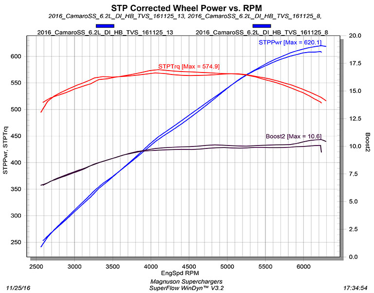

With the large water injection nozzle installed, tank full of WW fluid, and the AEM controller set to start flow at 2 psi and full flow at 7.5 psi we started tuning with the Rotofab intake until we found a comfortable power number which produced no knock across the entire run. The performance is shown below:
Name:  Camaro 91octane 620HP Rotofab.jpg
First off this is quite impressive. The most I can comfortably make on the dyno with straight 91 octane pump gas is right about 550 RWHP (not 1 off hero runs, 3 runs back to back runs that stay at 550 HP). This is an improvement of about 70 RWHP with water and Rotofab on 91 pump fuel.

But the biggest difference that caught my eye was the boost pressure - from 4000 RPM and higher at about 10psi the Rotofab provided at least a .2psi increase in manifold pressure. I ran at least 3 pulls with both airboxes and while each airbox had different impact on the long term fuel trims, the difference in boost pressure remained the same.
