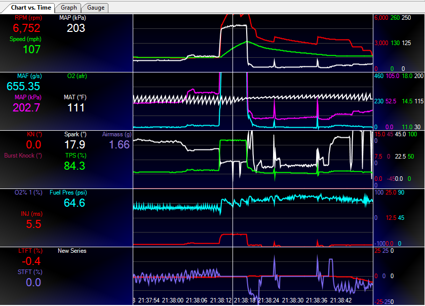

Hood open 1st pic.
Hood closed 2nd pic.
Where is all this extra air your speaking of? Notice the 4 degree difference in MAT temps btw with hood closed.
Its horseshit, which is why this vapoware intake wasn't sold and no one else is making similar.

Thats not what he said... I'm not the one with reading comprehension issues.
Rotofab and hood down made a few less horsepower and torque at the wheels SAE than stock. We raised the hood back up and re-pulled it and we were back to 10+hp gain over stock and ~10tq SAE. Drop the hood and it was down ~5p and ~!0tq from stock "(heat soak likely the culprit for the worsening numbers)."
Worsening numbers.......
Sitting on a dyno with an open top Air filter and actually moving at 60MPH are 2 totally different scenarios. Regardless, pretty much ALL builders say either the rotofab or similar designs make the most power over others.
I'm not a rotofab fanboy, but i do have data that clearly shows there's no gain in airflow with the hood up/completely removed, at least not on the big gulp.

Wrong, but ok. Cheers. It would be a gradual reduction, not a full curve drop with the hood being open vs closed. I've seen it, I dont need you to, but keep running that chomper lol. Keyboard grrr

The data is in the pics. Gradual reduction of what ??? Airflow? Tell me how that “gradually” changes. I’m not running anything, anyone that knows me knows I go by data and simply not by blind theories. I too had this same exact question, which is why it was tested by several people. I’ve even had a guy with his hood completely off test it (driving) The only changes were IATS which at that were minor.

If it was IAT related, it would be a gradual reduction in power not airflow, from heat soak on repeated pulls and IAT impact. We measured IATs too and they were not much different. The entire curve went up/down when we tested, repeatable over and over, with the hood position. I'll find the video and show you.
