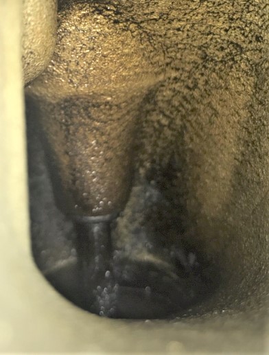

Originally Posted by Dixie ZL1 View Post
It’s not super significant, but more than I wanted to see after 11k miles. I installed a catch can during reassembly after seeing this.
That's a pretty big chunk-o-nothin'good on the valve at the base of the stem. I saw you posted in a NOS thread, was your car modded at all?
Brightened up the photo a bit...
Only mods are ported blower snout, 95mm TB, and CAI. I took the photos when the blower was off for snout porting.
