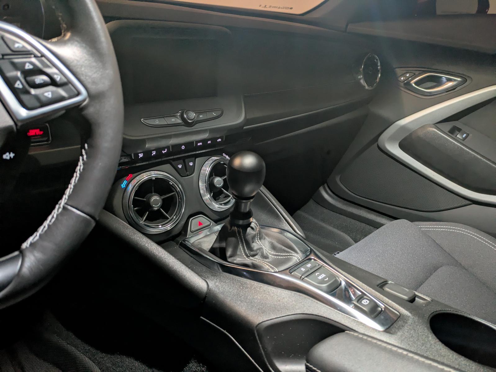

I received my raceseng knob & extender yesterday and installed them last night. I haven't drove the car yet.
Edit: Here's a picture. I fastened the adapter to the shifter 1" higher than the lowest position, because I felt the lowest position was too low. Actually, I may buy the 3.8" extender from Raceseng. lol

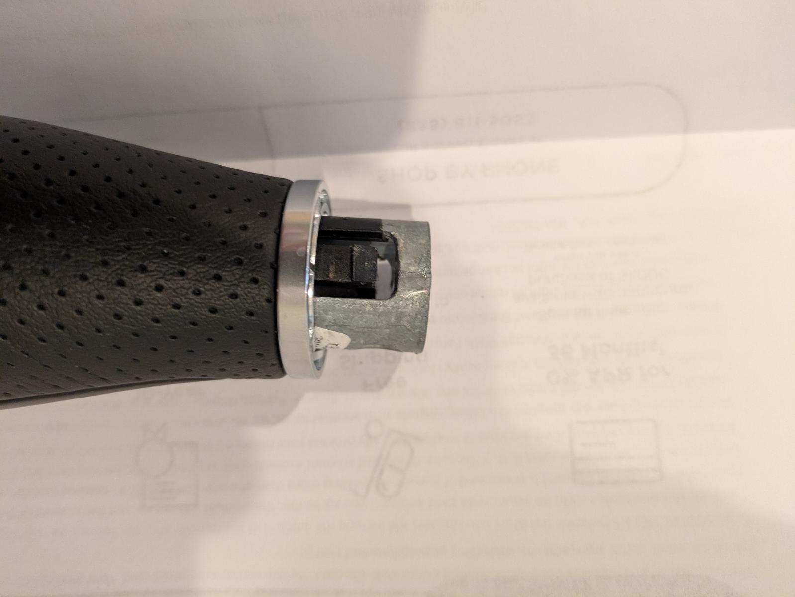

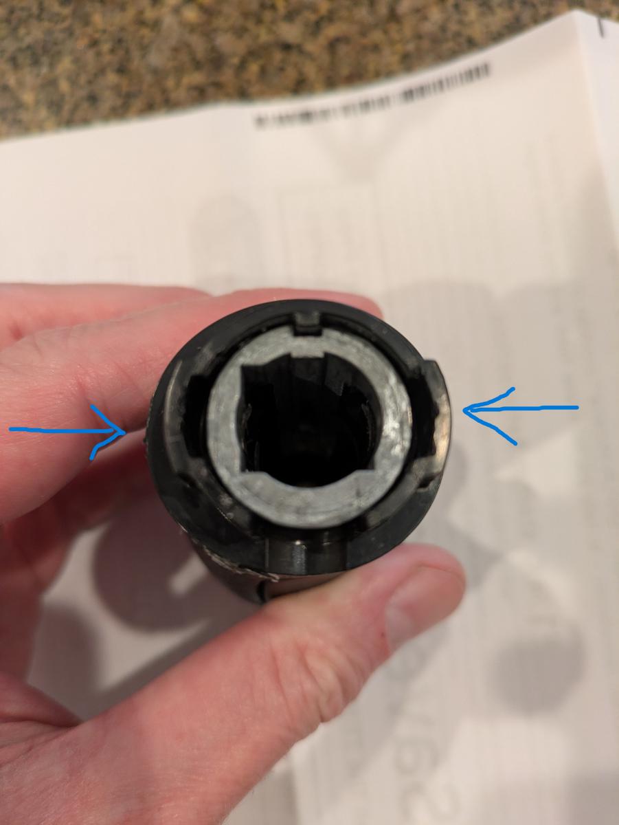

Side note: I didn't realize there are 2 clips on the OEM shift knob that help retain the boot retainer to the knob (see below). The clips are really stiff. You may try jamming a long/thin flat nose screwdriver in the opening on each side off the retainer to engage the clips on the knob, then try to pull remove the clip without separating the boot from the clip. Hopefully you will have an easier time of it than I did.
I suggest not removing the oem shift boot retainer from the shift boot (they're glued together).

I ended up moving the adapter all the way down on the shifter because the boot kept sagging when it was mounted 1" up. I went for a long drive yesterday and I'm pleased with the change. The added height and weight decreased the shifting effort and reduced the notchiness. It's a big improvement, but not a cure-all.
