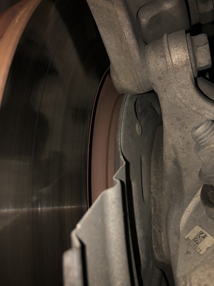

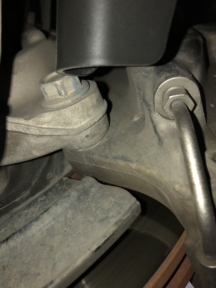

It'll work
I was doing an after track inspection and looked closely at the backing plate.
All you need to do is trim the backing plate just below the caliper to mimic the area just above the caliper. No way for material to get into the parking brake. Be sure to not trim too much so that you don't uncover the knuckle bushing is the only caution.
Pic 1 is just above the caliper
Pic 2 is just below the caliper
Both are of the driver's side
Keep in mind that this adds a little weight, split between sprung/unsprung...........

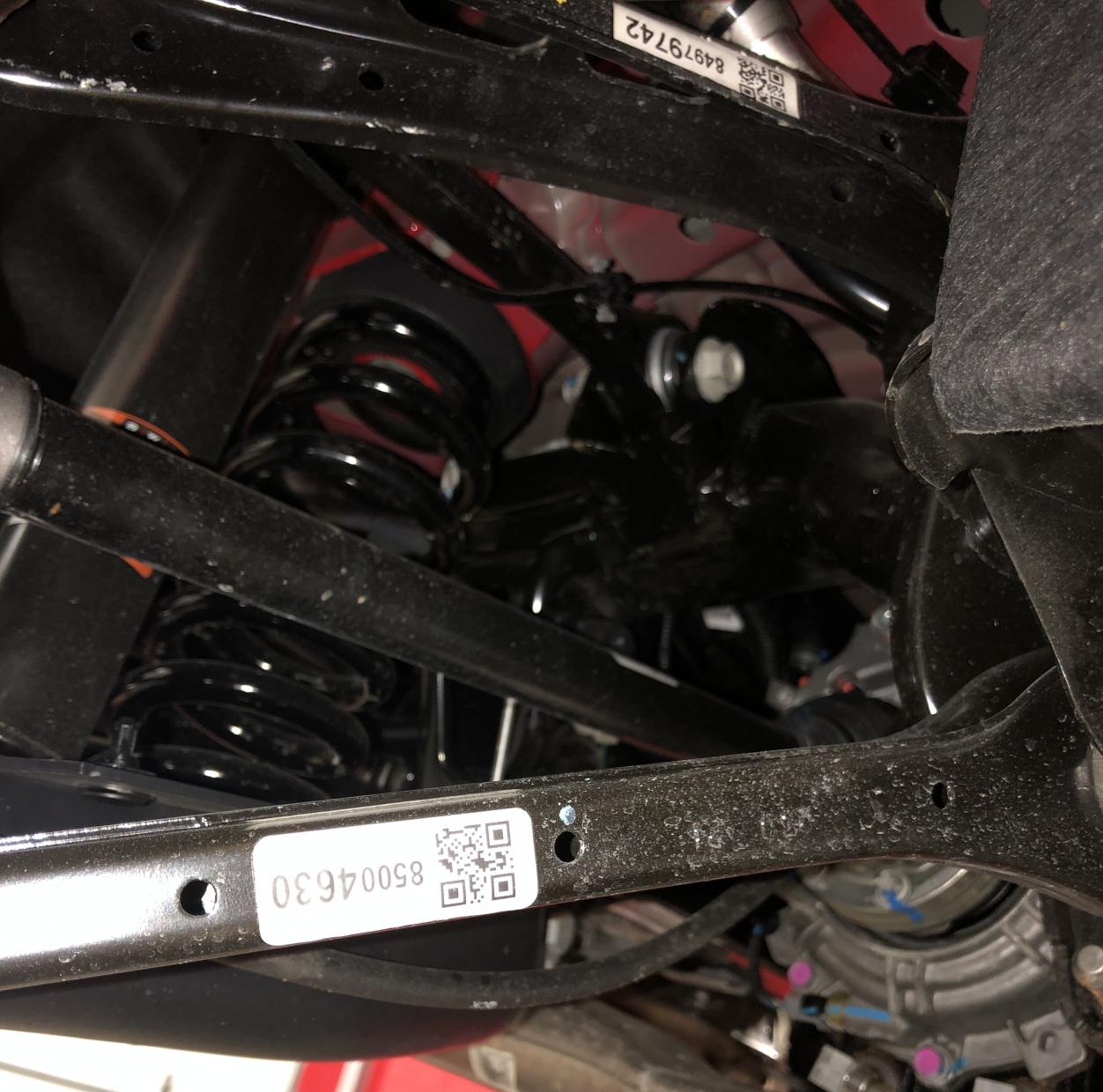

FYI - the 22 FE4 (SS 1LE and ZL1) [pictured] and the 22 FEA suspension (ZL1 1LE) both have the CT5-V Blackwing rear suspension front lower link stamping with the holes already there for the brake scoop screws. Both the same PN 85004360. The Cadillac FE4 has a different PN due to a different bushing durometer in all likelihood.
