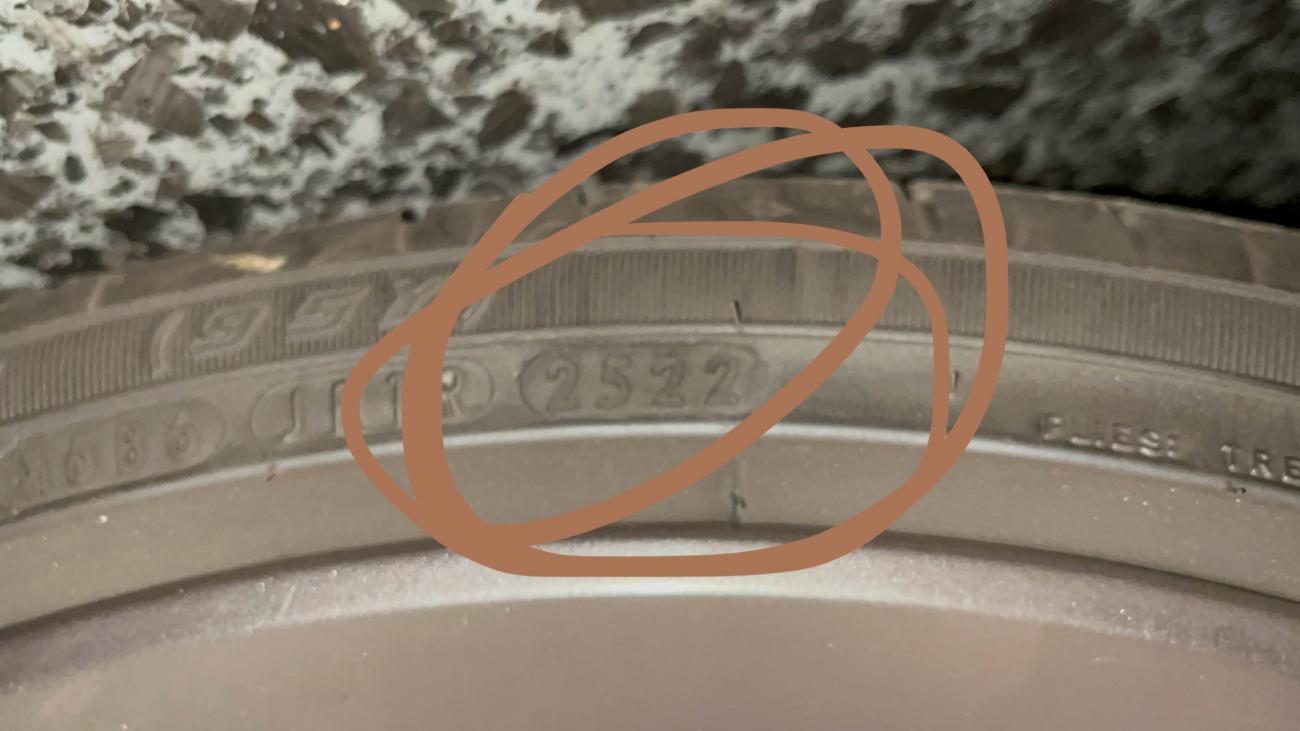

This is what the date code looks like 4 digits. My tires were produced in the 25th week of 2022.

Thanks dabjbr. I can definitely confirm that the d/c is 0320, 5 yrs old. I agree that it is very unlikely that the tires have been used, but I was expecting much more meat in them. Now you've got me second guessing. Also, the sidewalls do feel a little spongy to me. Not sure if that's normal because it is such a soft tire?
