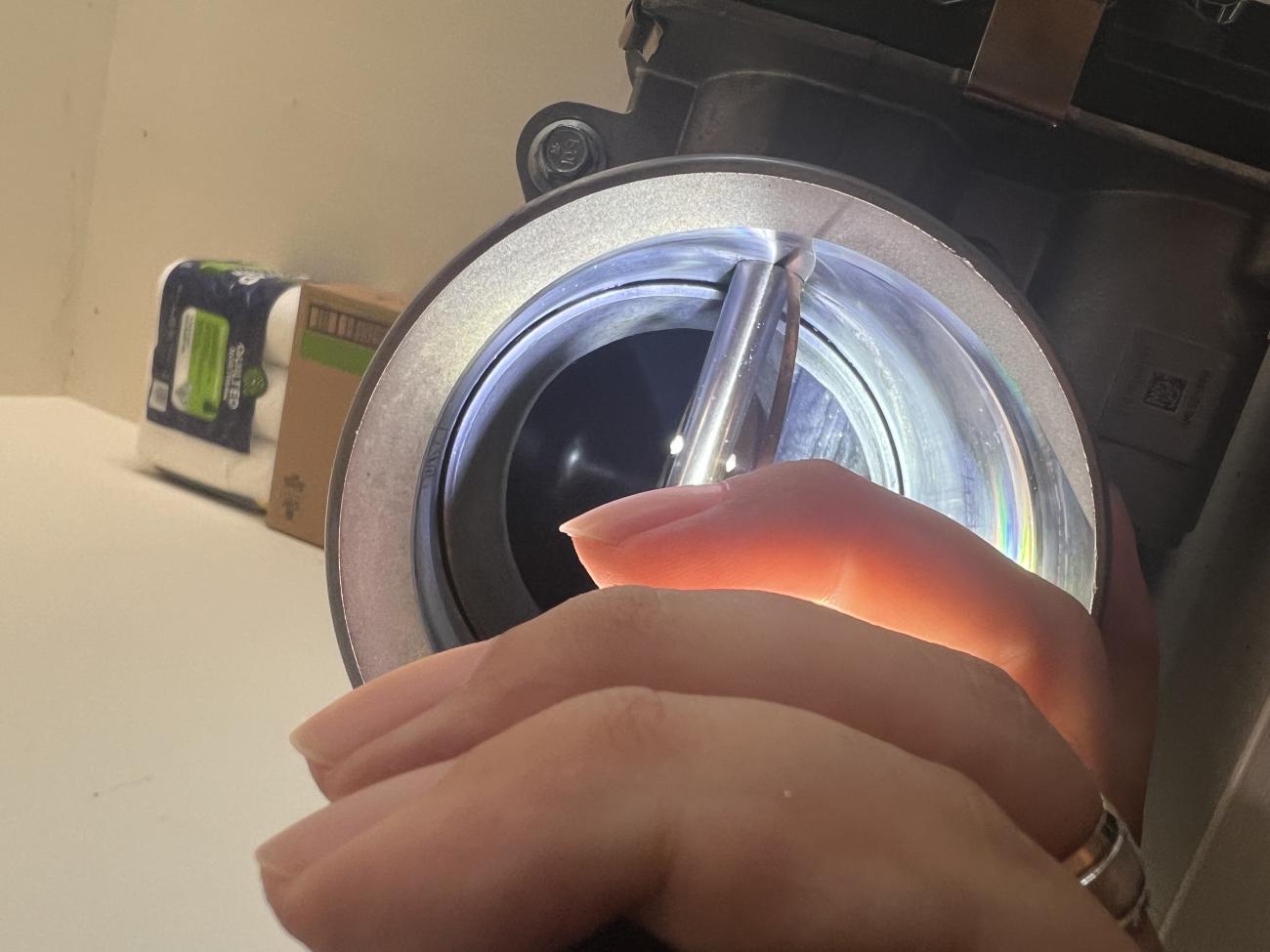

so I did some work myself, I looked up a modified mounting holes LT5 TB and port out the holes myself with a hand drill and 5 hours of time lol. The LT5 TB can be mounted on the LT2 IM without an adapter plate, however, the lip/o-ring grove is blocking the blade once its tightened... looking to port out the snout soon to see how it turns out

Posts: 548
Originally Posted by SSShark View Post
Here's how mine came out. The opening on my snout is actually 92, so everything matches. Once you open it to 95, I believe that's where you run into problems. Did you port the adaptor?
Does your lt5 TB have a smooth connection with the IM snout? My ported IM snout is way bigger than the TB opening and it tapers at the connection point

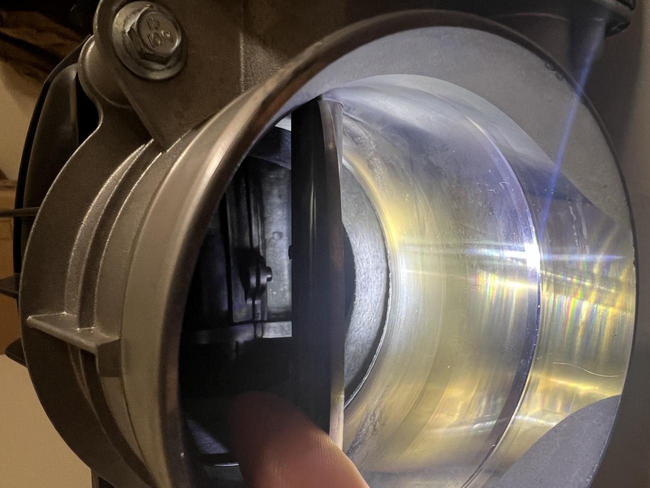

Posts: 1,539
Originally Posted by wang970305 View Post
do you by chance have a picture of the TB and IM connection point?
I have this pic of the adaptor to intake. The TB to adaptor is just as smooth. Great port matching job.
Where The adapter connects the snout is smooth? It doesn’t taper down?
Yes, it is tapered but smooth. You're going to drive yourself crazy by over thinking it so much. My setup works. I would recommend you to go the same route, you won't be disappointed
I thought the snout should be perfectly align with the TB housing, which is the port matching supposed to be? so the bottom of your adapter does taper down to the IM snout? I thought taper would create some turbulence. I attached a picture from Soler adapter, it is different size, but I thought it should be the same theory?
What you want to avoid is any stepping. There is really no way to port it without a taper.
