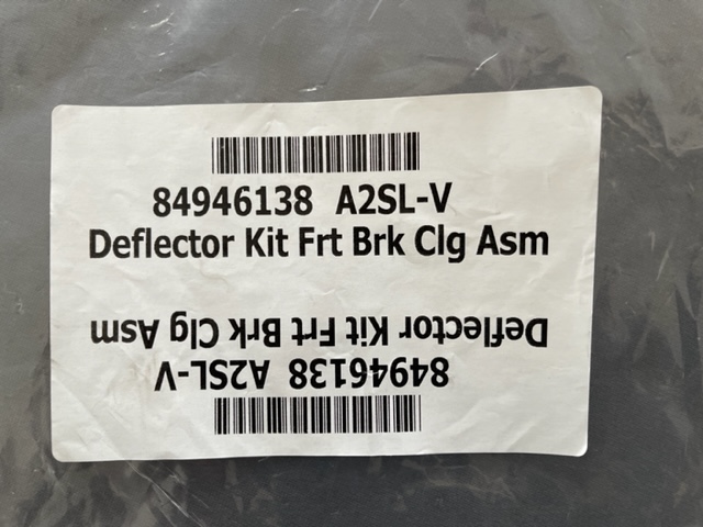

Sorry, I’ll get to this soon. It’s a possibility that they did not install the fronts during PDI and that I never received the rears.

Sorry for the delay. Holiday and all that that entails. In any case, it's all a bit confusing regarding front and rear as the sticker on the bag that everything came in says front and the instructions just say front however, they contain instructions for the rears as well. I believe that the fronts are installed during PDI and the rears is what you see in the pic which are only to be installed for track usage. Please let me know if any other pics or dimensions etc... are required. Don't miss the link below the pics for the installation instructions.

Is this the correct part number that we need to order for the rear only?
84946138
