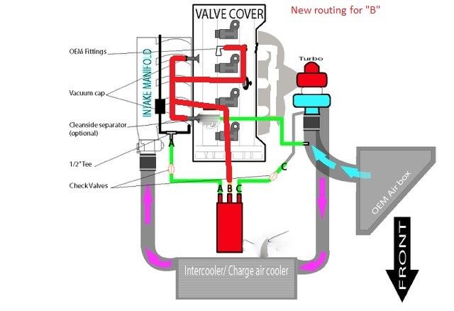

Our apologies, THIS is the correct diagram, we posted the old one my error.
Just for clarification, we have these on hundreds of 2.0T engines trapping oil and preventing the issues. And to go further, we still have the open challenge. Place our E2-X can in series after ANY other can and run 2,000 miles and drain both documenting what they trap, ours will trap as much or more that gets past the first can than it traps. Then clean both cans and reverse the order for the same miles driven and almost nothing gets past ours. That simple. Proven time and time again.

Originally Posted by Elite Engineering View Post
And to go further, we still have the open challenge. Place our E2-X can in series after ANY other can and run 2,000 miles and drain both documenting what they trap, ours will trap as much or more...
That's a claim that is foolish to make, dangerous to stand-by, and no right-minded engineer or scientist would make it.
There are coalescing filters out there originally designed for the aerospace industry that, on a car as a "catch can" will simply collect everything and anything fed to it because they were designed with that in mind. Every product has a cost target and a development budget - once you say "any" you open up to coalescing filters that utilize cryo processes, CFD nozzles, beds, reactors, and even ones with sacrificial media that requires regular replacement to enhance performance.
geoffchad is offline   Reply With Quote
