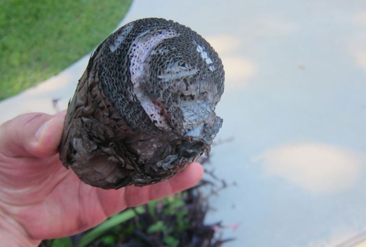

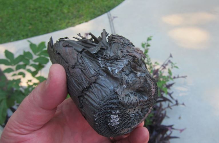

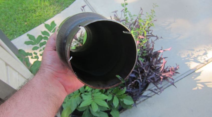

Originally Posted by Can'tHave2MuchHP View Post
Damn you were running high flows this whole time? Man if I knew that I’d have been warning ya. NO cats hold up to PC level of boost or FI engines making serious power like yours. You need a whole new header back exhaust just to be safe. Running it with any clog can cost you your engine in no time. Once it starts to disintegrate, it will keep doing so. It’s not all done now that I can assure you. The fact that it made it through the x pipe shows how much pressure it was under. New X, probably new mufflers, and no high flows.
I made that mistake two ZL1's ago. Never again.... My IAT2 hit 250 and my 3" Corsa Catback stretched so much from the heat that one side actually fell off the hanger in the rear.
One side blew all the way out the tailpipe and it was a good thing we tore it apart and checked because the other one was jammed in the X-pipe.
Originally Posted by Ricco View Post
I cant imagine Matt removed one cat but not the other.. Maybe it is a piece of cat that was just stuck in the mid pipe the whole time.
^^This... and check those O2 sensors too.
Attachment 951261
Attachment 951262
Attachment 951263
Attachment 951264
Attachment 951265
Damn. Yea, that's the crap that is now stuck in my Corsa Muffler blocking air flow at the split. haha. I'll have them check the O2's.

Posts: 38,033
Originally Posted by kttxz06 View Post
Got it. Thanks. duh. So, this was left over from the 1st blow out we had back during the cam install. This time on the left side.
The factory stuff 1 & 2 come out and HF cats replace #2.
I just called ARH and they sent me the offroad pipes. I did save the old cat pipes in case I ever needed them for inspection.
