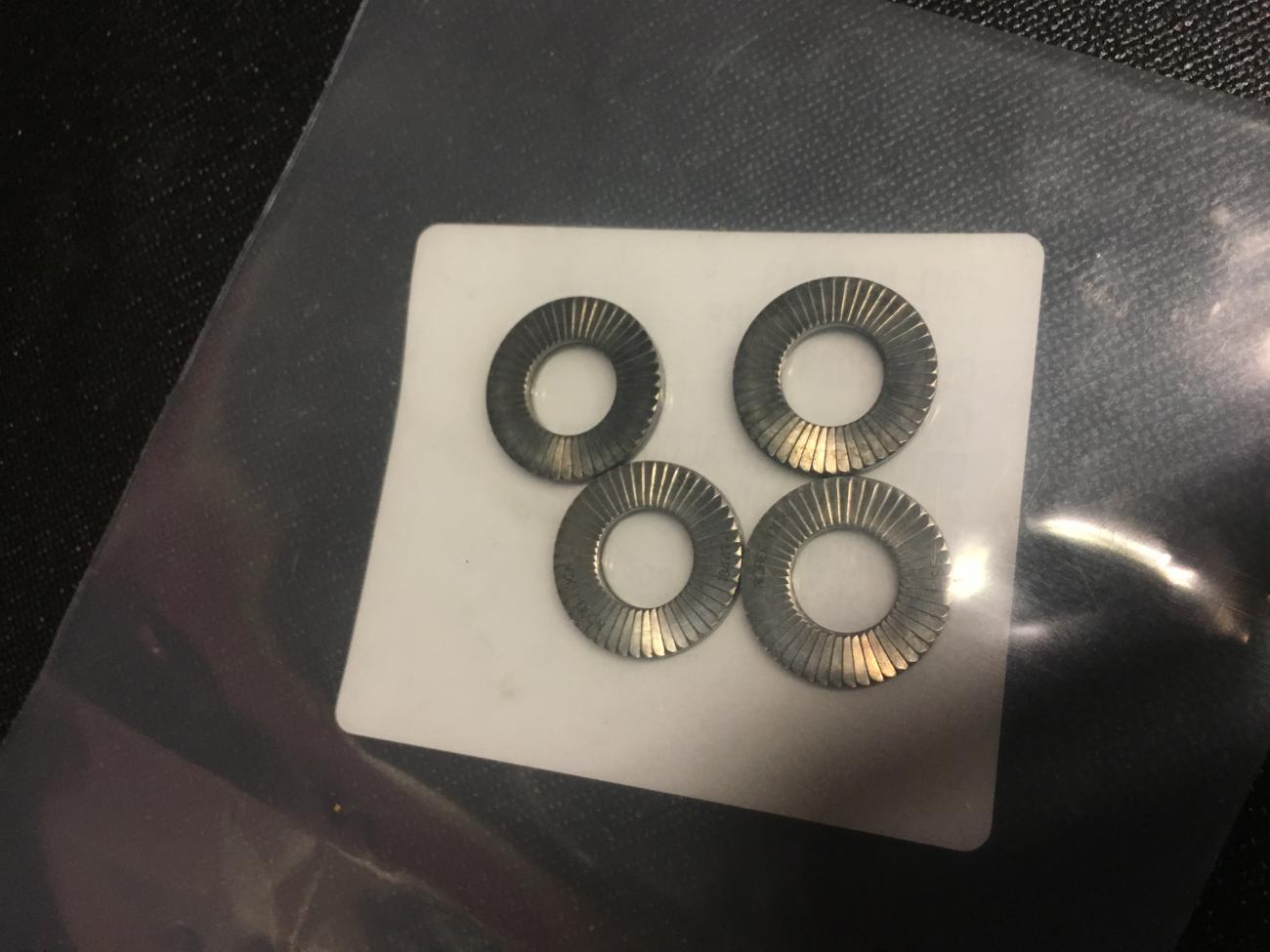

Take four 12mm Nordlock washers with you and be done with it.

The OEM endlinks are not the problem. The problem is the hardware used to attach them.Four Nordloc washers solve the problem.

Pete, I tried that and it still worked itself loose although it did take longer to do so. The factory replacements are starting to rattle after a few hundred miles.

Guys, forget the dealership. Use loctite or nordlock washers. Trust me. I took mine in twice for this problem and the nuts still came loose. I put loctite on, and it’s worked for the last 3 thousand miles. If they come loose again, i have some 12mm nordlock washers ready :-)

It's not the BMR end links. They've been checked a couple of times since. I have nordlocks and loctite on them. They're not loosening up any time soon.
