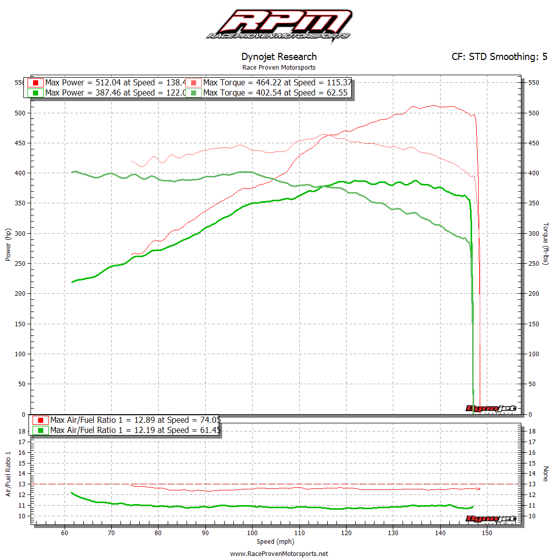

My 2017 2SS 50th Anniversary Camaro A8 ended up finishing up the dyno at 512rwhp and 464rwtq from a baseline of 387rwhp and 402rwtq. Turned out to be pretty good overall gains with this setup.
The complete setup that I went with for my car is listed below. The RPM team has been professional, and easy to work with. I highly recommend them to anyone who is considering some upgrades to make their car go faster.
- Race Proven Motorsports Heads and Cam Package
- Kooks 1-7/8 Long Tube Headers w/ 3" Catted Exhaust system
- MSD Air Force 102mm Intake Manifold
- Nick Williams 102mm Throttle Body
- K&N Blackhawk series intake
- Upgraded to ZL1 1LE Sway Bars
Nice.
Dyno Graph please

Posts: 39
Nice.
Dyno Graph please
As you requested.
