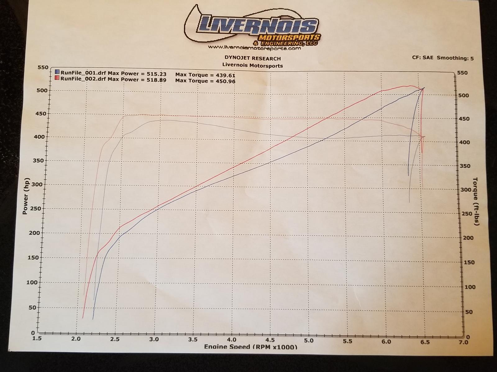

Mine was SAE. Sheet doesn't show smoothing.

Here was my run at the Rodgers Chevrolet show.... a bit disappointing...... everyone's numbers were low.....
A10.... sixth gear pull......

Wow those are low numbers...would be interested to see other vehicles on the same dyno same day to judge.

I can't vouch since I don't have a Zl1, but my Z06, same motor, dyno'd 568 at the wheels. A8. 100 degree heat. 100% humidity here in good ole Houston. Yea, these numbers are disgustingly low.

Oh that was your car up there, cool. I don't think we got a chance to meet but your car sounded amazing.
FWIW, the other two stock 6th gen SS's made 370's, which percentage-wise vs. the SAE numbers makes sense with your A10 ZL1.
That's the thing about chassis dyno's, they're relative, rarely absolute.

The guy at the sign up said it was a Mustang dyno but the graph said Dynotech? Not sure...... I will have better dyno session in the next couple months.
