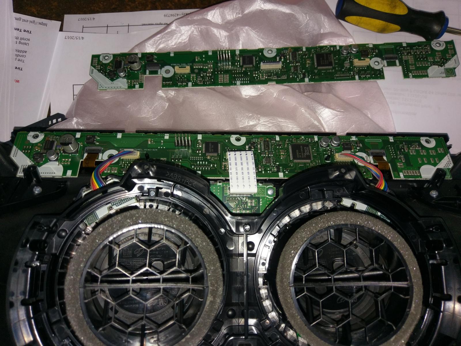

You can do a direct swap with the 2ss controls but the fan will remain on auto speed and must be adjusted through the radio for those not wanting to take circuit boards and switches apart. I drove like that for a few hours before deciding to take everything apart again and see about swapping things around.
Edit: just had another idea to simplify install. Hold on for this. Would be swap two parts and wire.

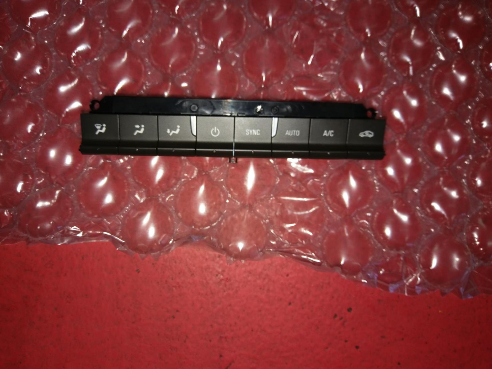

2ss ac controls.

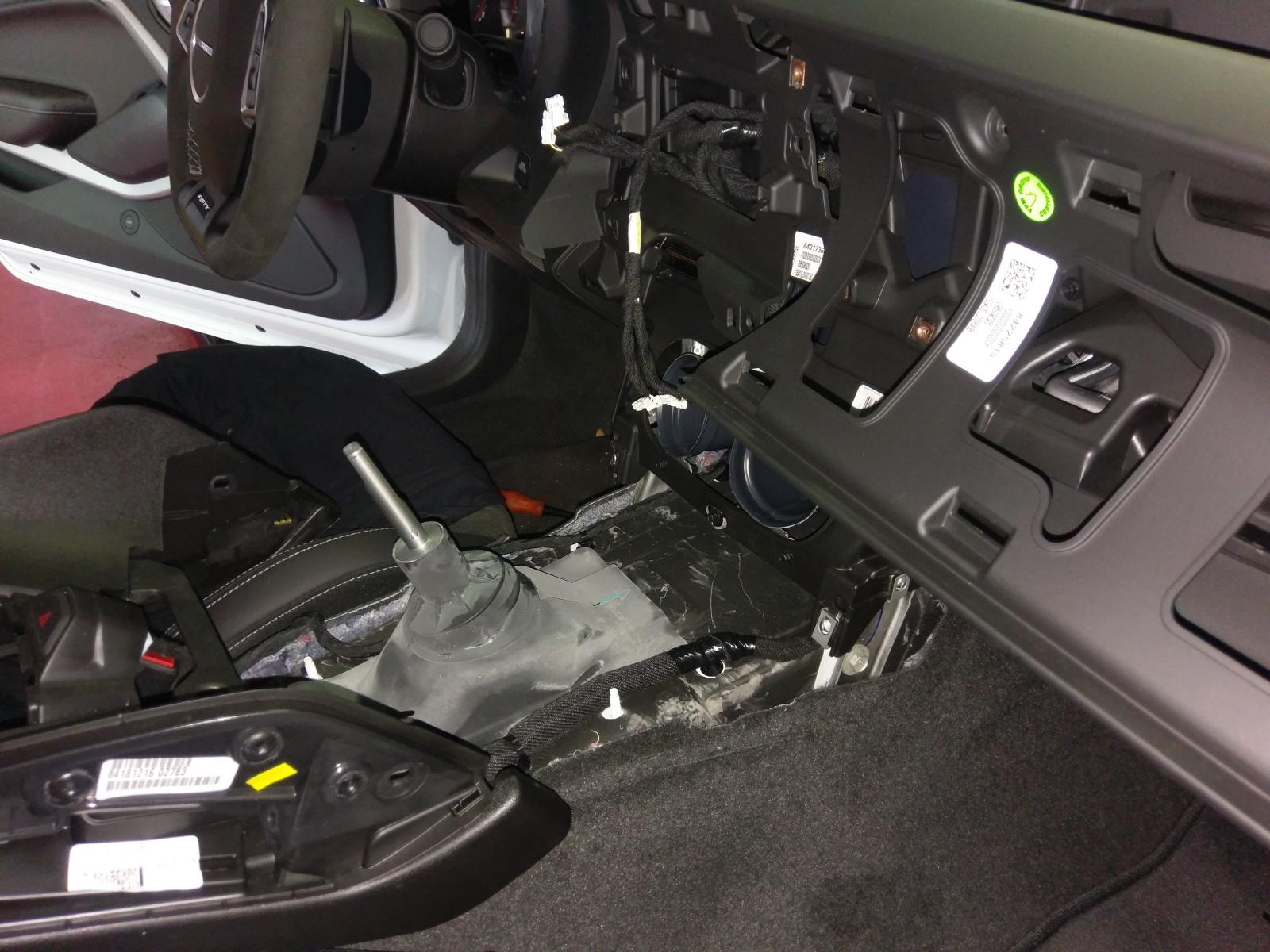

You will also need the terminals for the fuse panels and harness. Radio, dash, rear seats, center console and front seats will need to be removed, not difficult but time consuming.

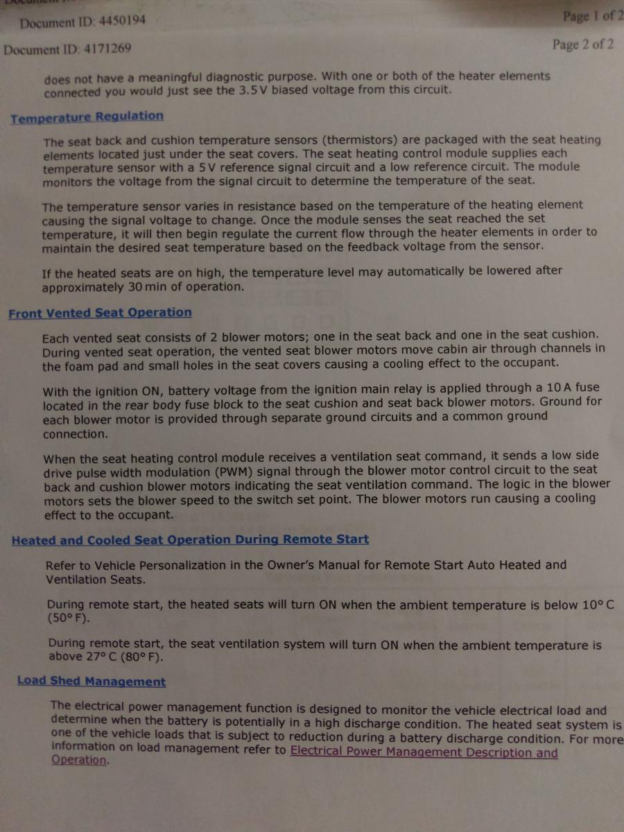

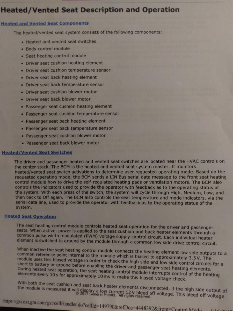

Would you mind sending me the system description doc that this pic is taken on? Thanks in advance...

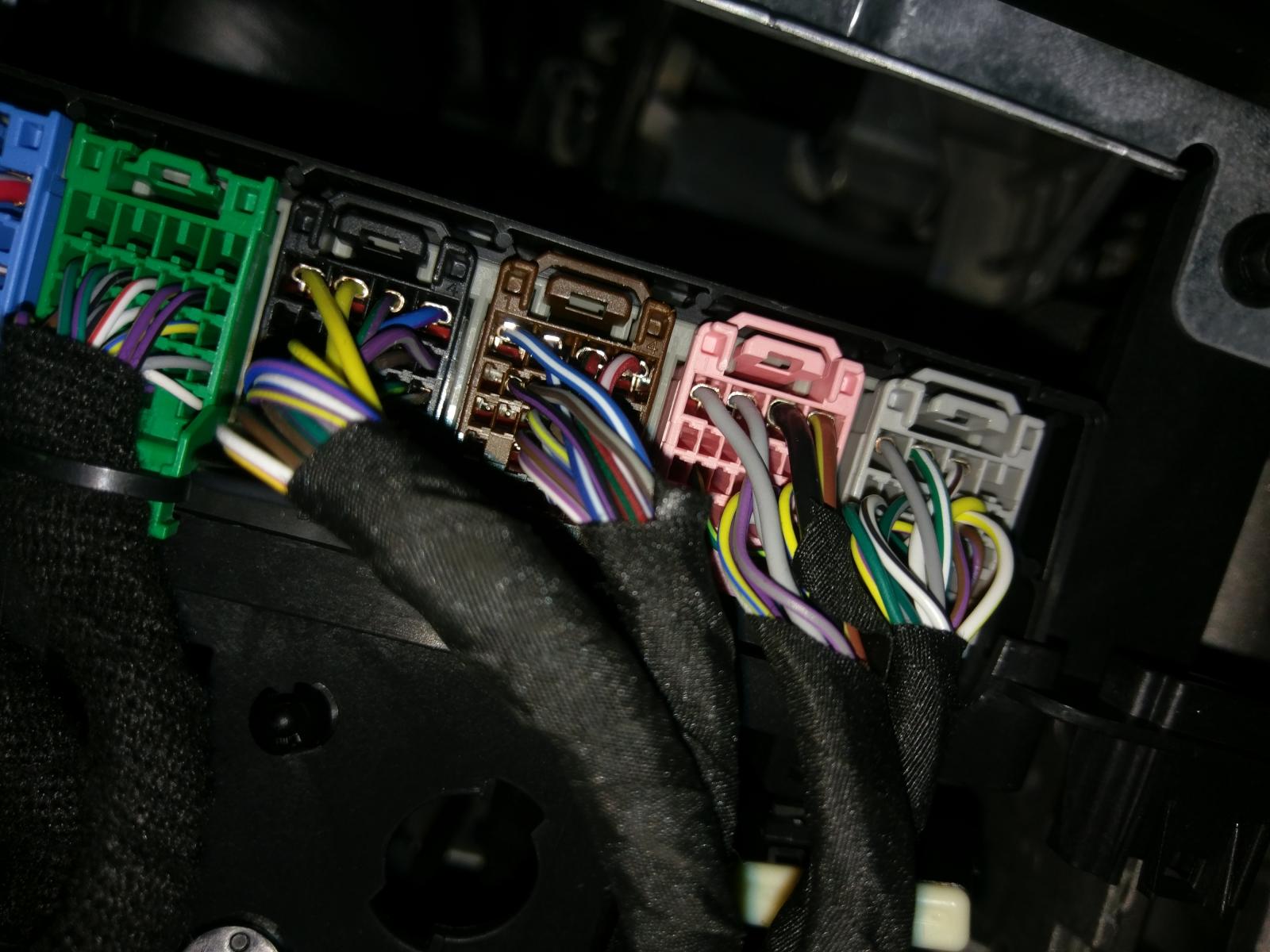

X6#9 wire on BCM. Net2bus.
I promise I will write all this up with pictures. Once complete.
This is the BCM. Sixth harness over, pink one.
Posted for all.
