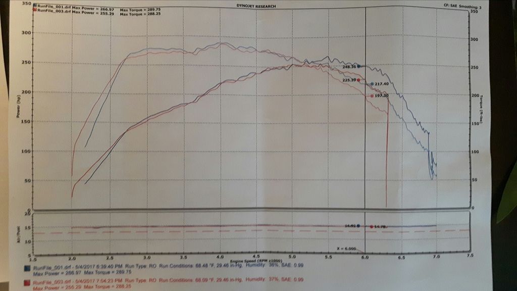

Nice. Do you a full copy of the graph? I'd love to see it!

That's first run and last. Five pulls total with 4 of them in 4th and one in fifth. We threw more fans at it and waited a good 15 mins before the last 2 runs. Obvious here that revving past 5500rpm is worthless. A tune can only get me so far before the IAT gets to be too much. Intercooler, maybe oil cooler, and thermostat are next on the list before a tune.
I don't think an oil cooler would really make a difference as far as cooling down the intake charge. It would be beneficial if you ran track days and were pounding on the car for 20 minutes straight.
