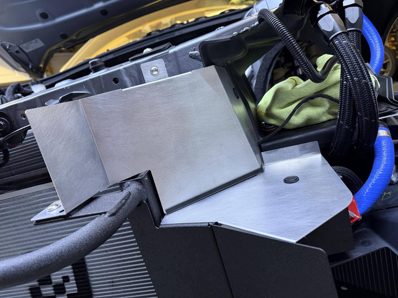

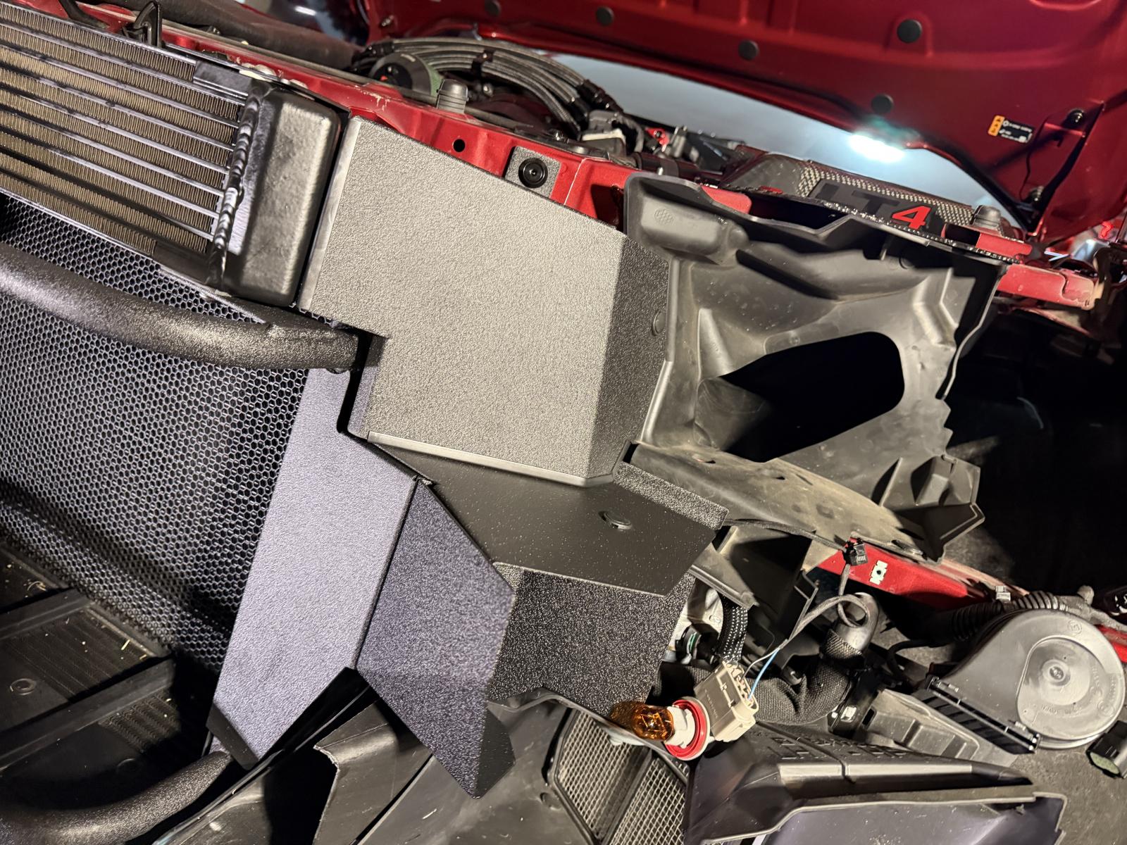

Hey buddy, yes... I ended up making one extra set now, and will throw it in for free for Camaro.6 peeps only.
I think it will be a $95 option moving forward, not sure yet...
Sending the 3 sets I have no to the coater on Monday, should have them back in 6-8 business days.
Hey Gabe,
Have you ever mocked up any ram-air panels for the oem crash bar version?

Hey Gabe,
Hey buddy, unfortunately not... only made a few for the Gen.2 crash bar with and without the stage.1 oil cooler. The Stage.II oil cooler doesn't have enough room to support it. Photos below of the version I made for the Gen.2 crash bar.
