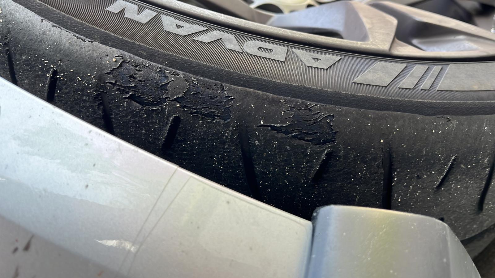

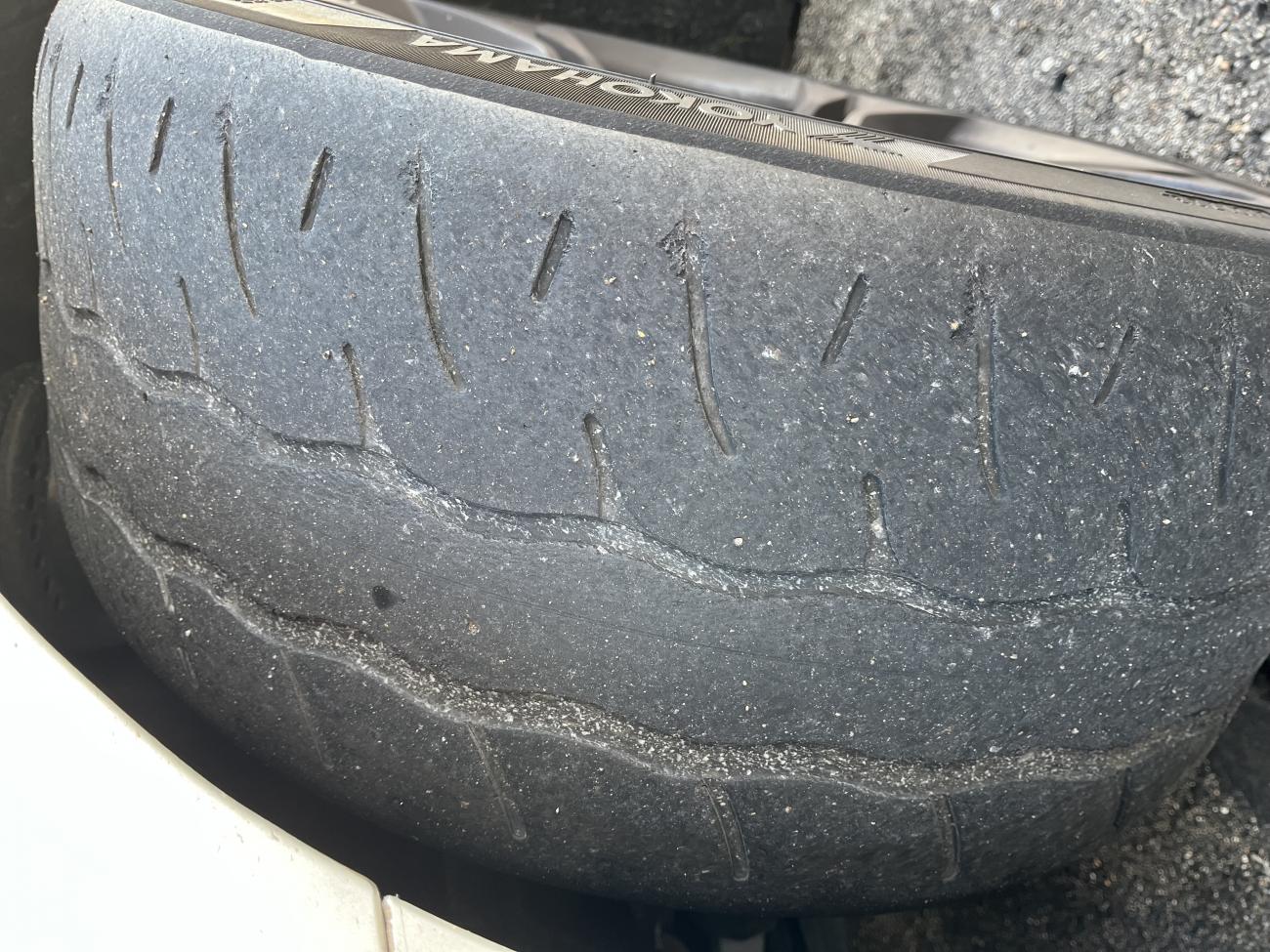

Hey all, so I started this thread about the AD09 a year back, and I have some updates. I have a year and 6.5 track days on these tires. Last year I ran them with an alignment issue I didn't catch, which lead to lower than expected corner grip, and me trying to compensate with too low hot pressures. I ran them down to 30psi hot in a few sessions at Pitt Race.
While the lower pressures helped get better grip, it also caused the outside shoulder to get excessively torn up.
I was at VIR last weekend for a full weekend event, and I loved the tire after fixing the alignment. It had very good grip, and more in reserve for when I enter into a corner too hot. Also gripped well at 34 all the up to 38 PSI. My opinion of the tire took a 180 turn after getting the alignment fixed. I will be getting another set.
The shoulders are now pretty torn up, so I need a new front set at least, as the rears are still ok. ~5000 street miles and 6.5 track days on these. Wear on center is quite good still, just barely on the wear bars.
But what do you think? Can I get 1 more track day on these before I see cords?

Hard to say for sure without knowing what was fixed on your alignment and where it landed. If you have all the stock front camber (hopefully -2.7ish) and no toe or maybe a smidgeon of toe out, you might get away with one more track day on these. I'm no expert, but it looks like those maybe blistered. If so, I'd send it it: the rubber underneath could still be good. OTOH, if that's the last of the true tread compound showing through those holes, then it's not a great idea to use them any more for track work.
