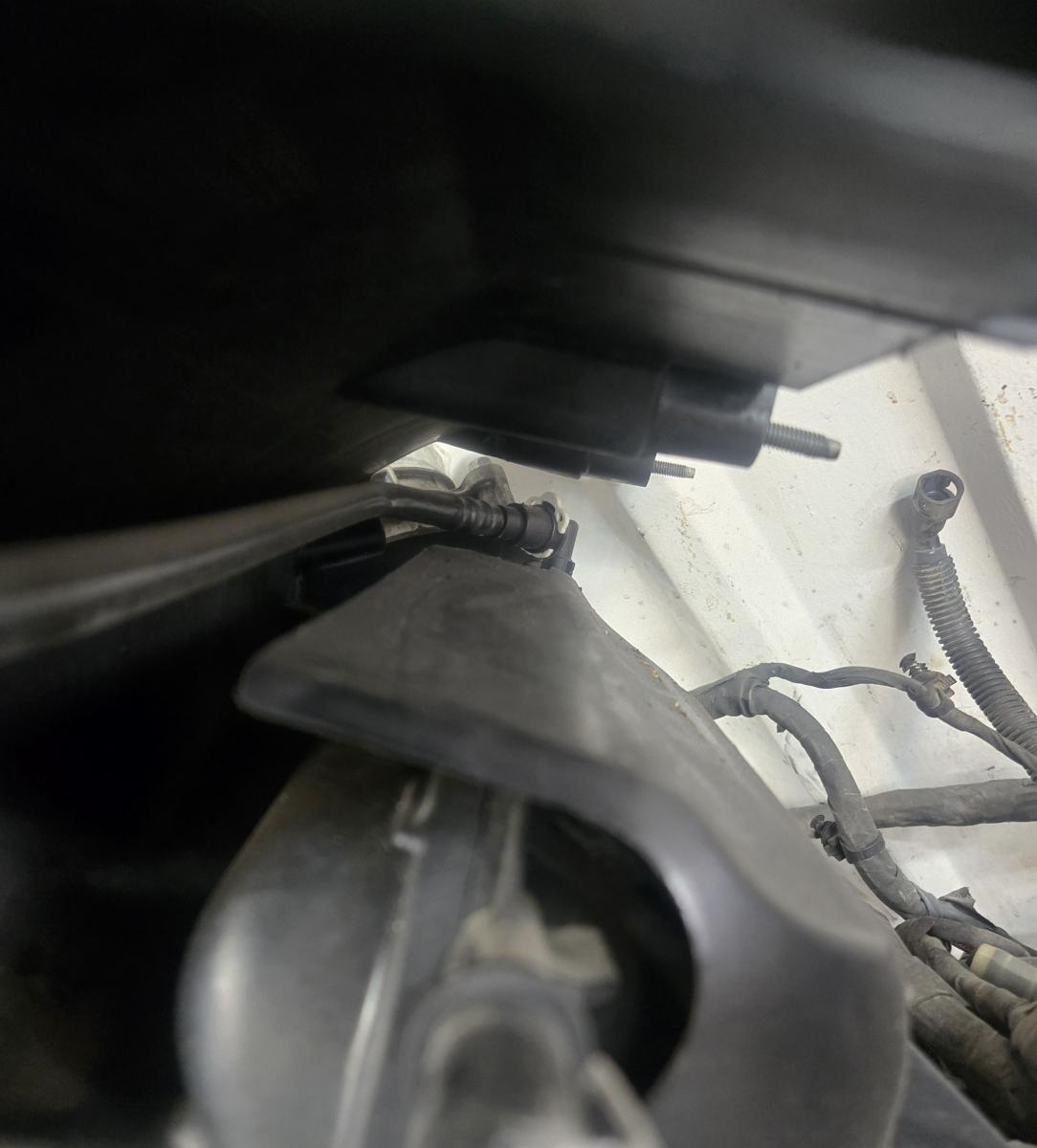

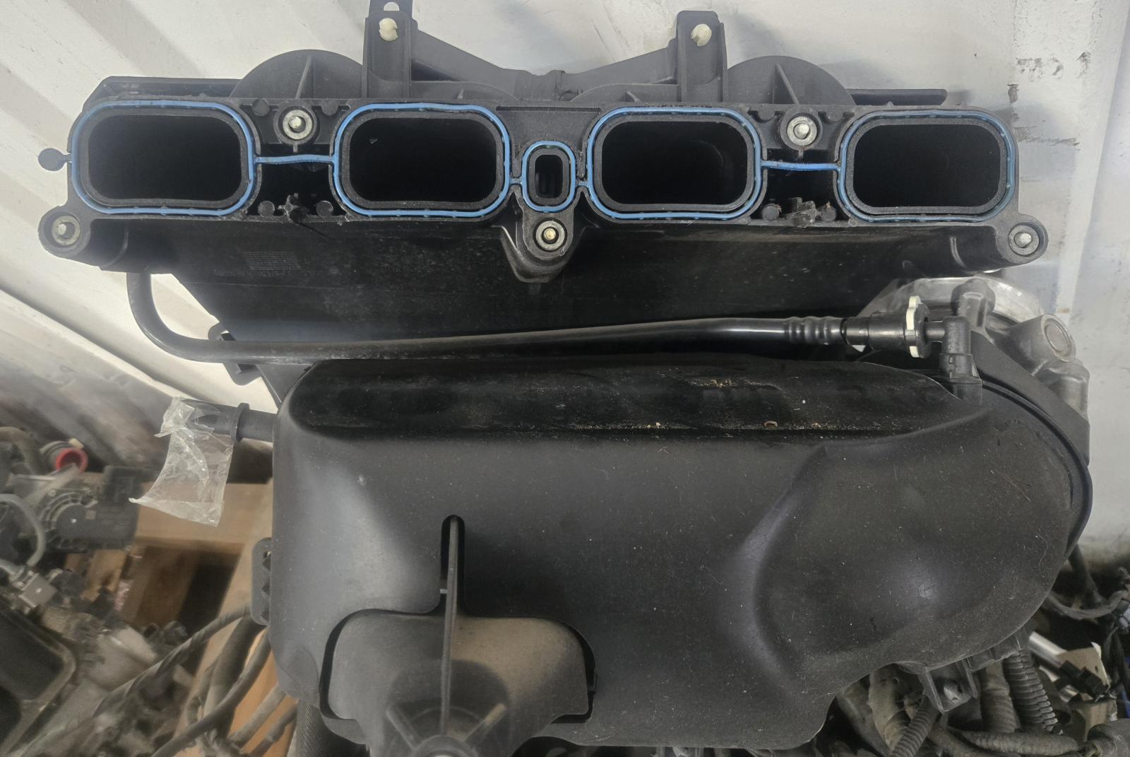

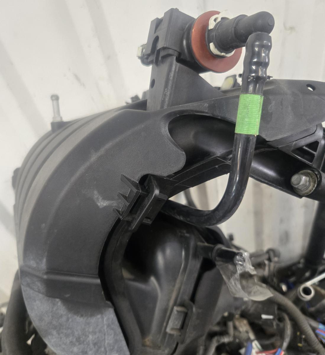

Here are some pictures to show you. The line is sourced from the manifold just after the throttle body. It will still be a vacuum leak but a much easier one to control.

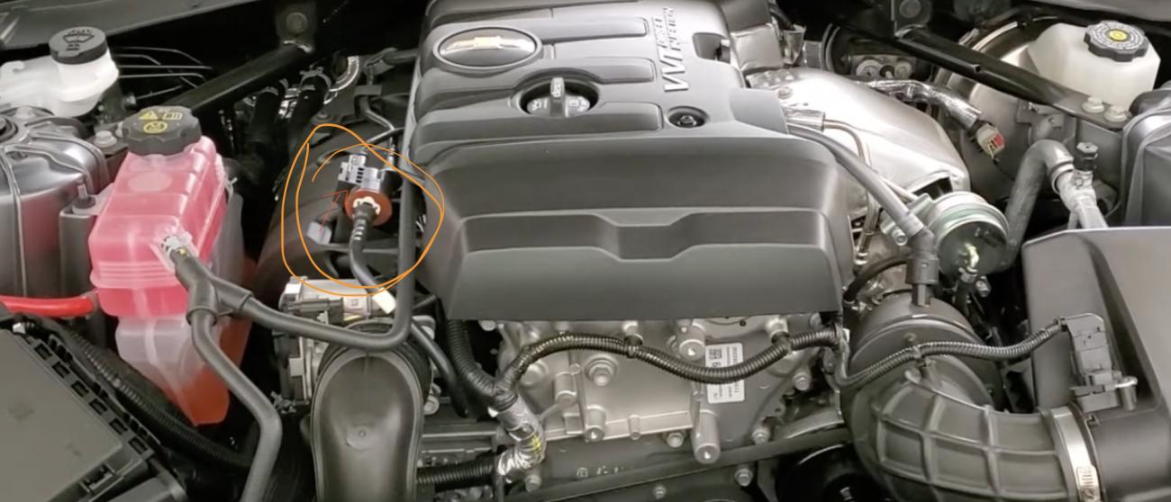

So asked the service guy today how to get the CRC spray in there and he mentioned taking off the intake, i think you might be right it might not start or struggle to start. So going with your idea in the attached image, i think you mean this part right? is that the intake vacuum line? I guess pull off the clip and red part and spray crc in towards the back of the engine?

Its kinda backwards from the one i showed you. You push that white tab down and slide the hose off the red thing (which is the purge solenoid) then you spray into the hose. The hose is going down to the intake manifold so yes you're looking into it correctly.

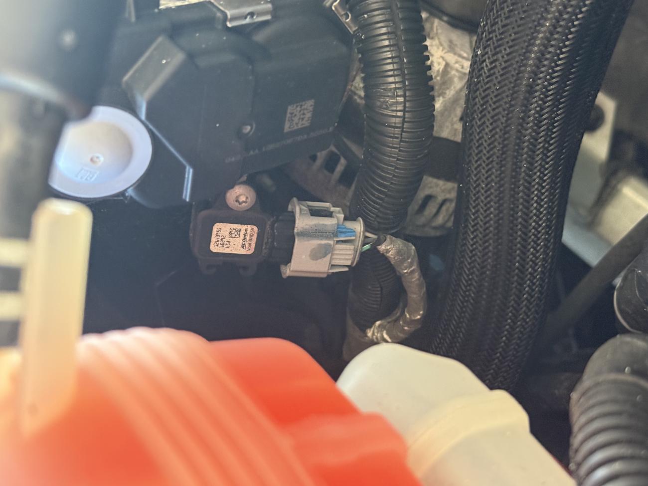

Thank you I was able to get this done yesterday. Found another entry point the MAP sensor which is right after the throttle body attached is a pic. Unplug, unscrew, pull out and spray in. I did about 75% of the can into the MAP sensor port and 1/4 into the vacuum line. I removed the throttle body plastic hose and wiped it down, it was not in terrible condition but there are two spots on it I couldn’t clean of. Forgot to take a pic of it.
You were right I tried starting the car with the throttle body plastic hose off, the engine died within a minute and threw off the check engine light. After I put it back on and had about 4 drive cycles the check engine light turned back off
