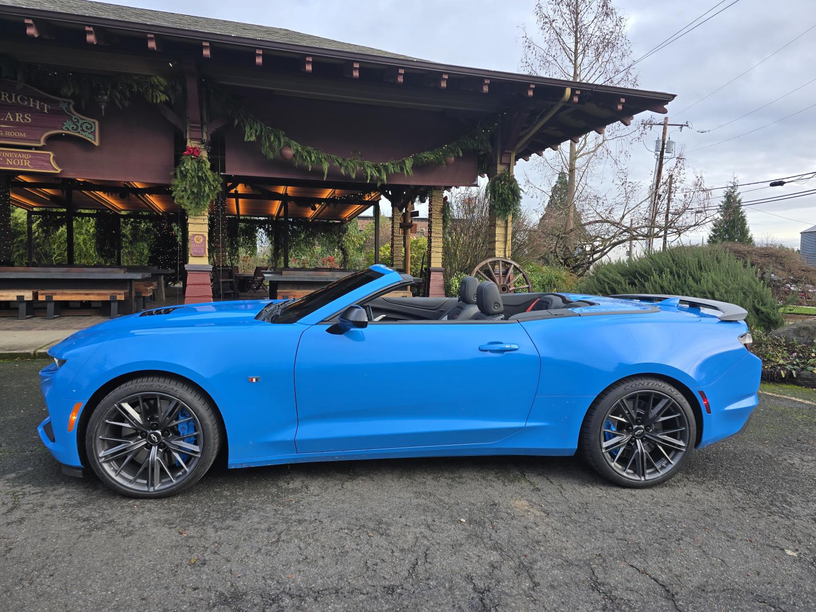

I recently installed ZL1 brakes on my 2023 SS. All you need are ZL1 calipers, rotors & brakes pads. Keep in mind there are 3 different sizes of 6 piston calipers for the Gen6 Camaro & each uses a different size rotor.
My 2023
It's nice to have options.

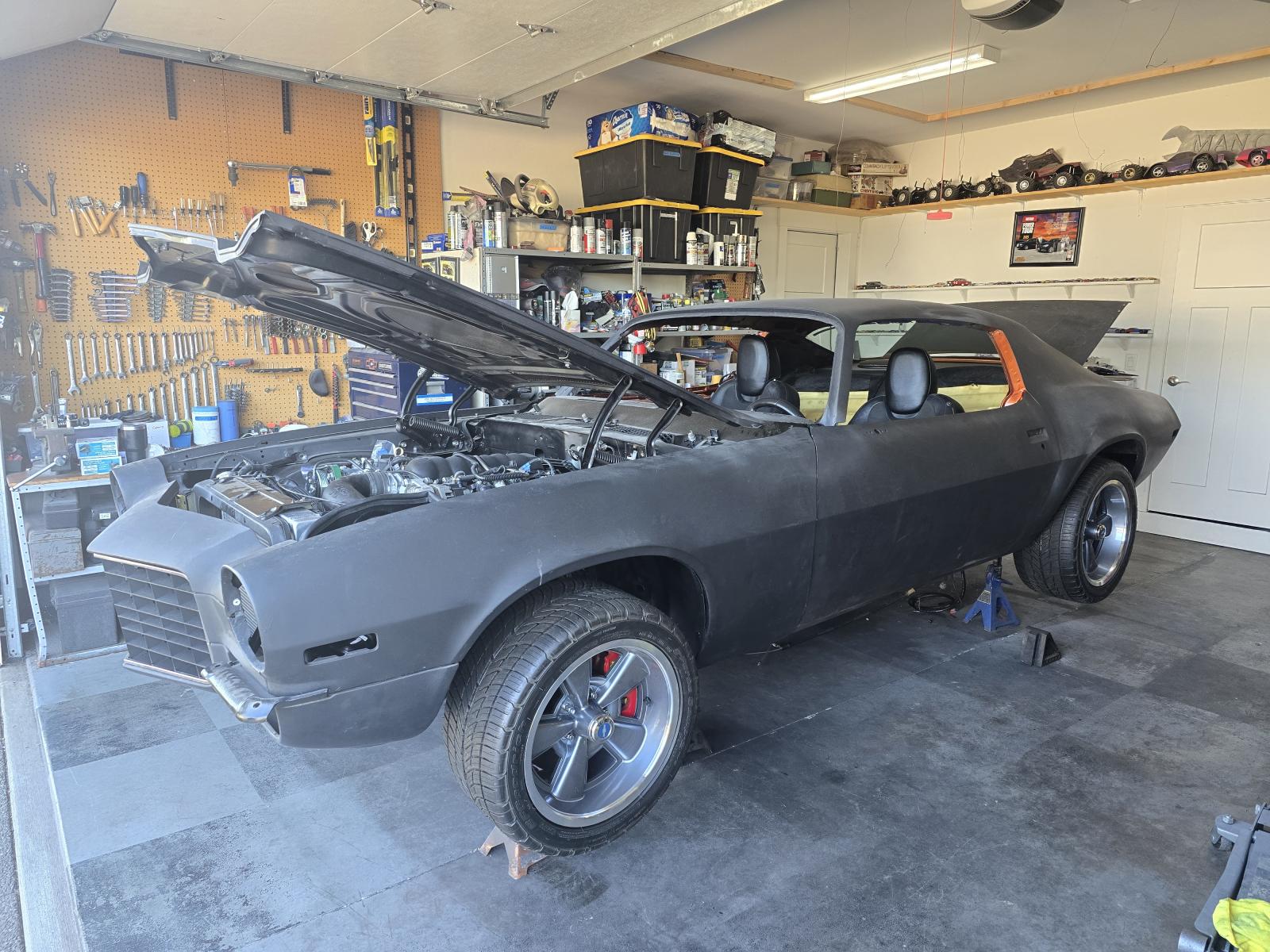

The ZL1 calipers cleared the SS brake shields so didn't replace them. No plans to track the 2023 being a convertible. I have my 1973 Camaro to do some track time once I finishing building it.
She's a real beauty already, congrats on your build in advance
