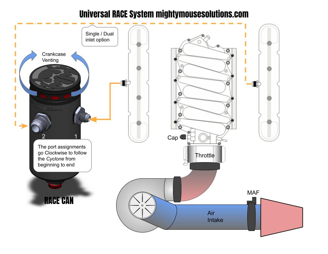

The saga, not surprisingly, continues.
MM now says, "you can't run a pcv can (wild kit per title) like that for sure related to the mess out of the breather.
Change the internal to the race 3" here
https://www.mightymousesolutions.com...yclone-upgrade
Unless you need more than 1500hp of capacity in which case i suggest our xl size race can + clamp which is good to 2k
I also strongly suggest venting from the front of the covers. Is this a race car?"
Update:
"The way it's hooked up with the center you have now for PCV only one valve cover was venting the one that was ran into the old exit port does nothing:"
Mine has been set up wrong from day one.
I'll buy the 3" internals, move the bungs up, and shorten the lines. LME put the bungs on the rears, but MM says don't.
This work was done by the now infamous Shop #1 I focused another thread on. Fakes.
2020 ZL1LE A10.

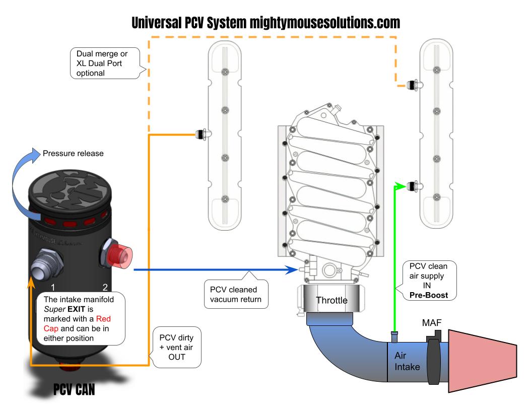

In summary, the infamous Shop #1 sold me the setup in the first image which should have been the second image. And based on mighty mouse's comments yesterday, this error was the likely cause of me pushing out my rear main seal.
I have yet to determine if one can distinguish between the 2 cans just by looking at them from the outside. Because MM is sending me the race can internals which also fit in the wild can.
2020 ZL1LE A10.
100 octane: 1045hp/1055tq.

The second picture isn't PCV that's CCV. A glorified breather. The first picture The red fitting will be a PCV Valve. Not just a bung.
The first is what I have, but the second is what I needed. Rather than having two lines flowing vapor to the can, I have only one line because the other line pushes vapor against the pcv.
Two flowing lines will be much less messy for me than a breather. My engine has a lot of ring gap compared to OEM. Top ring gap is .023", 2nd ring gap is .025"
