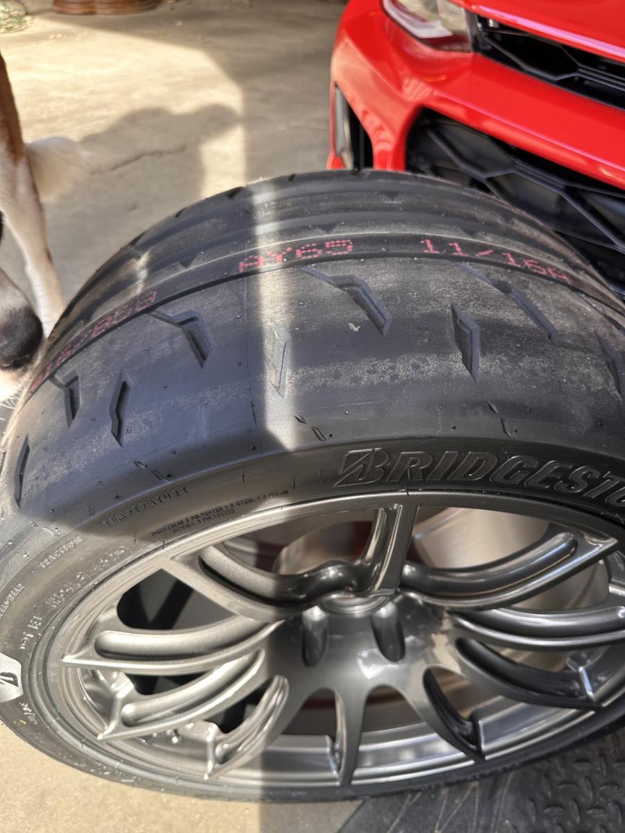

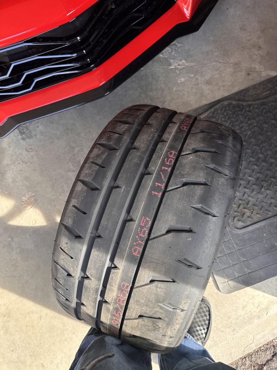

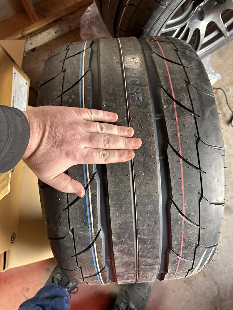

New tires mounted to the new wheels. Not sure the stock lug nuts will work so I am waiting on those and I will need to do the wire harness move before I throw these on the car.
Nitto 555RII for two of the wheels and the other four are RE71RZ's.

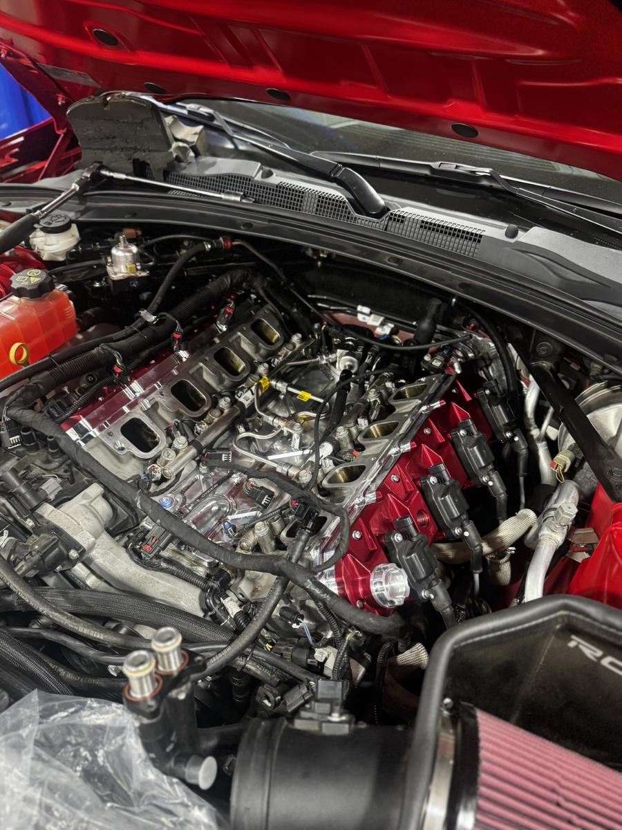

LME valley cover and TooHighPSI valve covers installed.
Brought my car to a new shop to figure out the noise. It was definitely coming from the new fuel pump. Old fuel pump had 4 shims and the new one didn't have any so maybe it was bottoming out. I sold my motorcycle so to celebrate that I bought some "while your in there" parts for the new shop to put on. Also putting on a catch can from mighty mouse that should be here tomorrow. I also ordered a TooHighPSI lid for the 2650 in red.

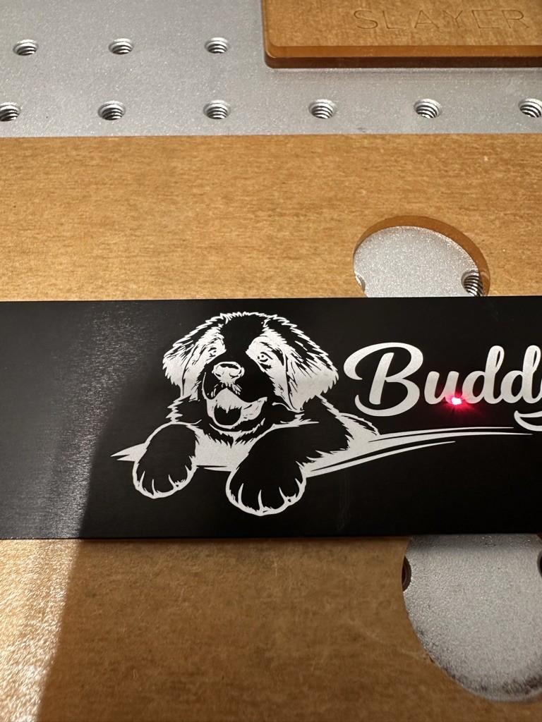

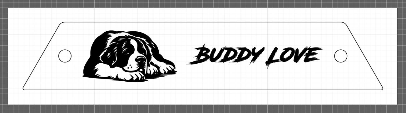

I decided to name the car after my first St Bernard that we had to put down last January. He definitely was my number one guy. His name was Buddy and his trainer gave him the nickname Buddy Love when he was young. So I am naming the car "Buddy Love" and this is what my plates will look like on the supercharger lid. I tried making my own design with chat gpt but it didn't come out clear enough for them to use. Went with a generic St. Bernard design.

Here is the Image I sent them (and the real picture I used to make it). But this is how it turned out when they tested it.
